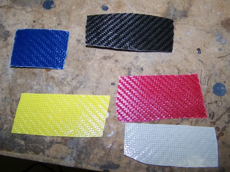

I received a sample pack of the fabric some time ago, I just never got around to testing it. I will lay it up tomorrow and post a pic.
Looking at the fabric, I dont think it will look very good. Well not what I’m looking for anyway. Have to see…

sample pack from Solar composites, its colored e-glass just not what I’m looking for.
Clear poly resin, just a wet out on a piece of plastic so its not smooth…
