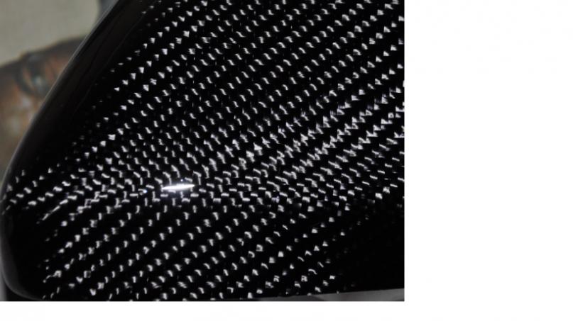

attached is a shot showing the part after clear
That is not so bad. I would buff it up a bit with swirl remover, then on to the next job.
thanks, that’s my first overlay project and my 3rd attempt @ spraying clear :), i have a few overruns on the part and i’m not sure how i should handle them :frowning: without having to re-shoot clear again after blocking the overruns, any leads will be welcome :slight_smile:
It looks pretty good from the pic, if you have a few runs, take a stir stick (tongue depressor) and wrap it with 1,500 grit around the top of it, wet the area and press your finger on the top edge of the tongue depressor with the sand paper on it and with light pressure sand away the run.
You can lower the grit to a 1,000 but bear in mind it will show and need buffing as such, usually 1,500 will remove it if it is not a big run and then you can wet sand the rest of the piece out and buff away.

thanks SLS. so after blocking the piece with 1500 and buffing say with perfect-it from 3M i should get the piece more shinier than before
(or as shown on the pics attached earlier)?
Remove the runs, make sure the clear is level by blocking wet as well, go through the grits from 1,500 to 3,000 and then buff with perfect it and yes you will have a shiny piece. Just remember, if you are using an orbital polisher that speed doesn’t help, slow and steady, you don’t want to high of an RPM.
