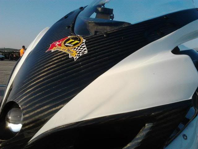

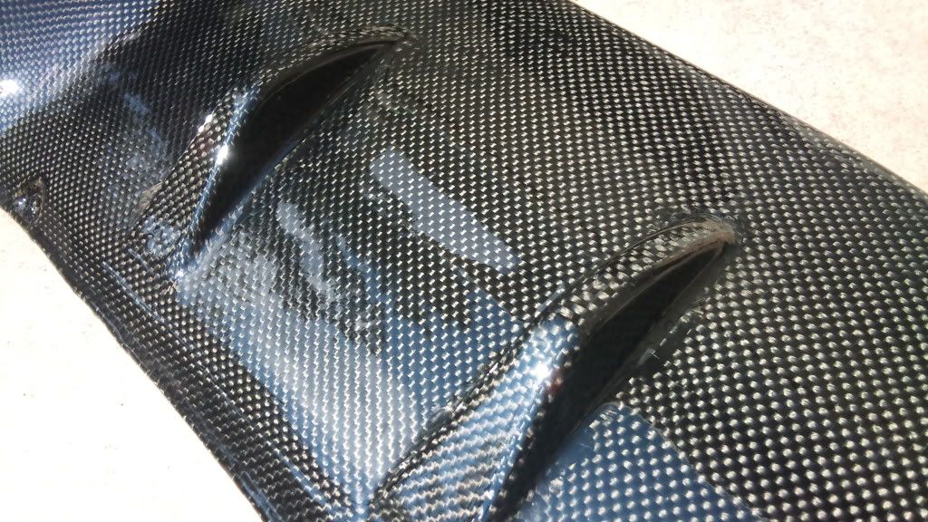

Same deal as up top ^ No gelcoat ever, been this way for years…we use to spray duratec, PPG clear, etc…etc…now, nothing, no clears, no gels, nada…
Now we just ensure the mould surface is the best possible result we can achieve and frankly, out of 10 parts - 8 are about perfect. It’s all in the surface quality guys, moulds are polished weekly.
They don’t last as long because the surface is wet sanded and polished wearing down the surface coat but in the end, we spend way less time finishing the parts off and because they can be a tad larger, the idea of spending hours upon hours wet sanding and clear coating gets tiresome. Plus, the guys get really proficient at making moulds when you are turning them over yearly.
I think these have 2 hits of clear on it, wet sand in between just to level it.
