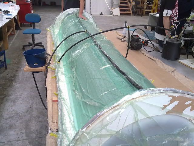

Here is a photo of a mould we made a few weeks back. It is 6 4m^2 layers of 1200gsm glass quad, it took 12kgs of resin and an hour to infuse. There is also another part out of shot on the left being infused at the same time. I’ll break it down from the pump(s) to funnel/bucket.
-You can see one pump on the table and the green hose going to our big pump from the black resin pot. These have a quick release fitting.
-The pot has a brass push on barb, which we wrap tacky tape on before pushing the hose on. If the barb blocks I drill the resin out, easy.
-19mm Nylex garden irrigation hose with tee’s. Again we wrap the tee with tacky before pushing on the tee.
-Electrical spiral wrap, vacuum is around the edges and inlet is along the top.
-Inlet going to the fuket (funnel bucket) where the is a barb glued into the bottom of it.
Also you may see a little blue thing on the bench by the chair, it’s an ultrasonic leak detector (http://www.tequipment.net/AccuTrakVPE.html). They are expensive (around $300) but they will pay for themselves in less wasteage and time looking for leaks.
