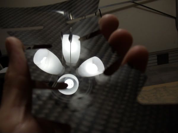

REZCAR: Duratec produces a high gloss, pretty hard surface that looks good and is easy to buff to a class A finish. The down side is that it isn’t UV protected. If you are spraying it in mold in a thin layer the color will not be that noticable. For my particular situation I use a pretty thick surface coat that is why the color is a problem for me. I would definately recommend Duratec for a gel coat application to take care of porosity problems. It’s a great product but for my application I think that I need to try a different route since I’m not looking to spray post fabrication. I’ve posted a pic of the duratec finish below.

Thanks for the pic. This whole time I thought the Duratec was UV resistant. Time for me to go looking for a solution too!
