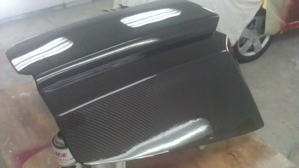

Here is my first hood with straight carbon, layup schedule as described above, it weights in at about 2 pounds. I would like to stay in that general area of weight.
