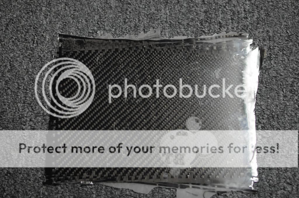

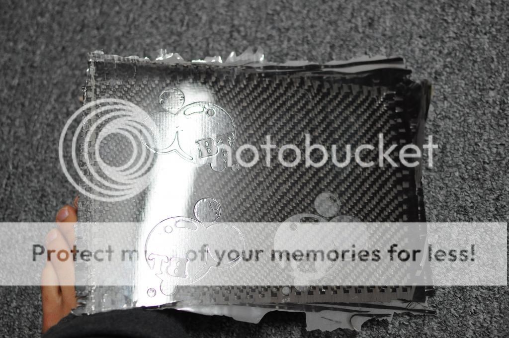

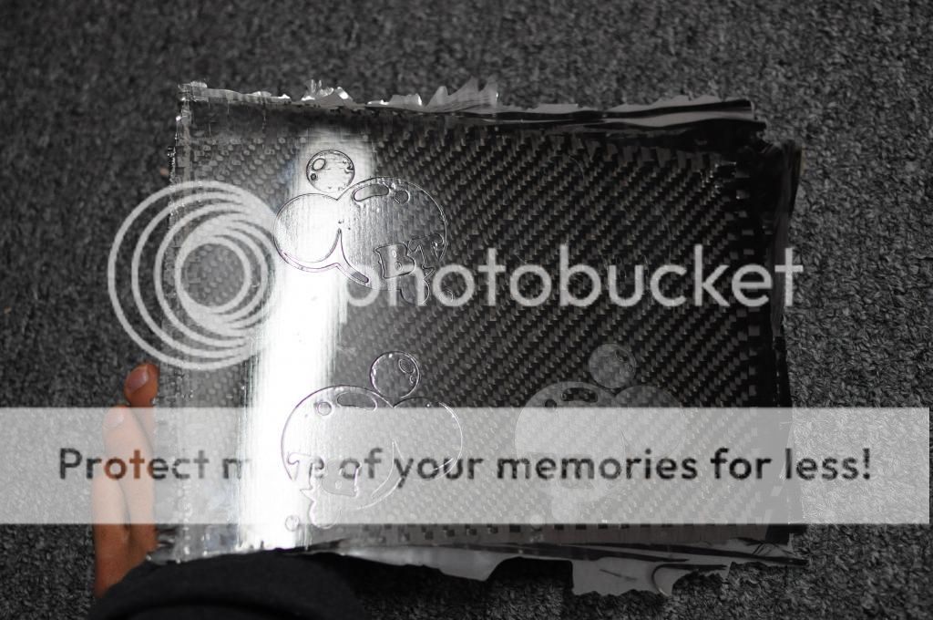

I did some testing over the weekend, pretty good results! I’ve tried 1, 2, and 3 layers of vinyl cut decal as well as matte/gloss finish decals… the matte finish leaves a pretty sweet finish!
(ps since i was testing i was using scrap pieces so some images are mirrored by accident, some on purpose)
the gloss decal had some air bubbles hence the imperfections…
Matte looks realy nice! Nice clean option if you don’t want to use any colours and still well noticable!
