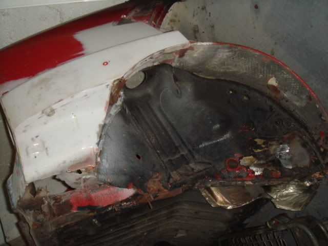

Ok, here is a pic of the underside of the rear wheel arch:
Pretty scabby eh? That’s because here in the UK it’s very damp and we put salt on the roads in winter to stop them from freezing. Old Italian cars don’t need much of an excuse to rust, especially when the makers don’t put plastic liners in to protect them (they did at the front). The stones get flung at the metal arch which gets worn and chipped to bare metal then rusts. Mud gets trapped against it which holds the water there and makes things worse.

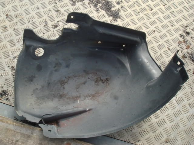

I intend to create a wheel arch liner made from composites. Here is what a wheel arch liner looks like:
It should be relatively easy as a fantastic finish isn’t needed, I just need to smooth over the intricate and sharp parts and distance the new liner a little bit from them hence me thinking of using wax sheet.
The problem is I haven’t used it before so hoped to find out more before buying some…
