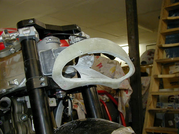

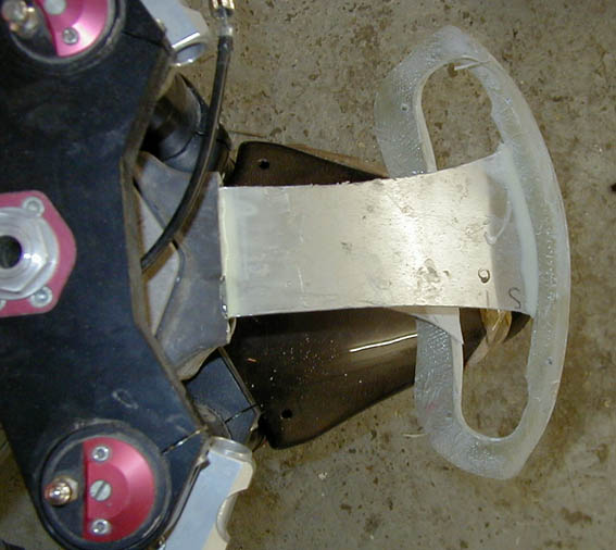

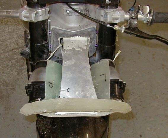

start with a rough ish collection of parts for the basic shape,

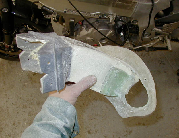

then some infill with foam to shape,
then apply filler for further shaping,

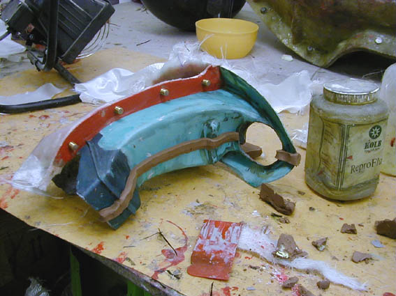

then the resulting multi piece mold

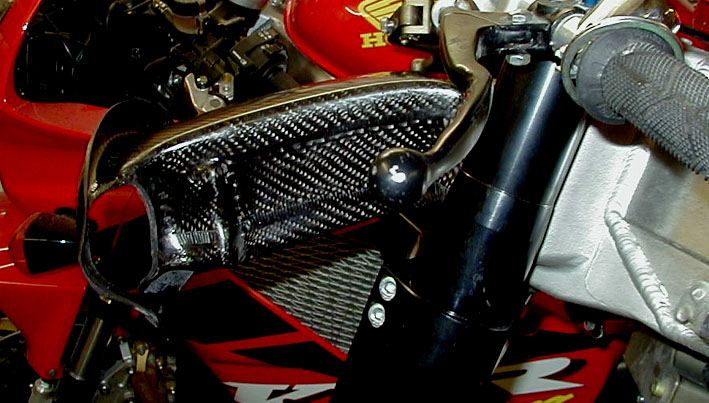

and the finished CF item.
In the finished item photo the ‘join line’ can be seen horizontally along the part where there is overlap of CF cloth.
