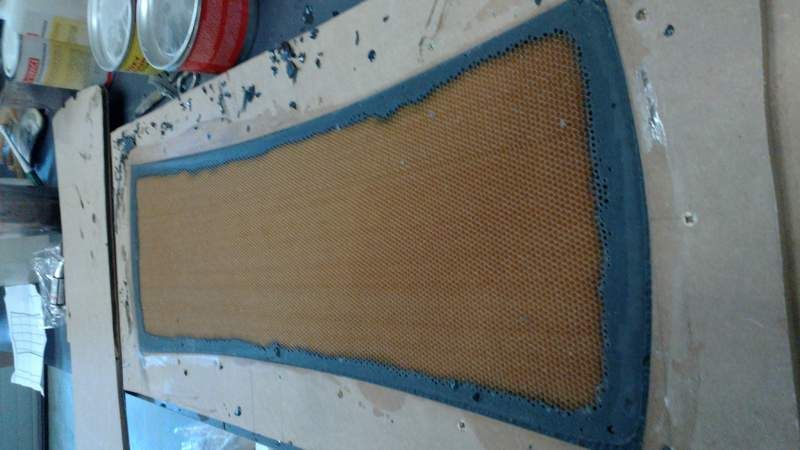

Why not cast directly to the core? works for me, in cheap mdf moulds :wink:
interesting… can you show me? im very curious…
-david
Ah I see… This could perhaps be adapted to what I need to do… Thanks! I’ll think on it!
