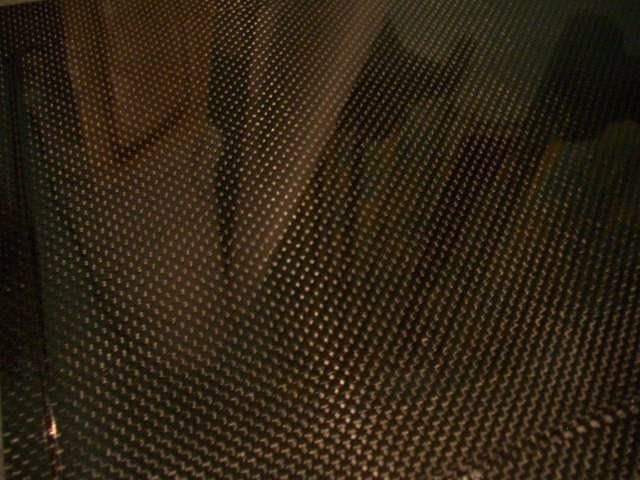

well after 2 years research/trial and error/wasted materials/not listening/no patience etc etc i have finally produced a ‘perfect part’ via vacuum infusion,what a fantastic process,anyone who is still messing around with vac bagging,do yourself a favour and make the move to infusion! many many thanks to the people on here especially problems,baznoz and werksberg,without all your free and honest help this would be mission impossible.
ok so its not the most exciting part and its fresh out of the mold but its 100% perfect in every respect which is awesome

im gonna make a few more of these just to perfect the technique and i have some more molds i need to finish before i can do some slightly more complex parts just trying to decide now if its gonna be best to try and polish this bit with some special fibreglass polish ive got or try and spray it with laquer,i dont have spray kit so it would out of a can and every time i do that i end up with a spec of dust ruining the whole job! any advice?

You did this without any duratec in the mold first right, so the carbon will be right on the surface, clean any residue of release agent off first then lightly abrade with 400 wet or dry wet. dont worry you wont ruin the weave. Then a bit of panel wipe to clean off any contaminates, you can then clear it from a rattle can. Give it a few coats letting it flash off between coats, put it to one side for a week or two then wet sand with 2000 wet or dry before compounding with something like G10 or even T cut, no need to use G3 itll be to harsh. You should end up with a finish like glass. So don
t worry about a couple of dust specs, they`ll disapear when you wet sand. I usually use duratec in the mold first and if the part is not exposed to the sun a lot you can just buff that without clear coating it.
As an experiment i have left a part (just Duratec, no UV protection) in the greenhouse all summer and so far there is no discolouration and we have had a reasonable summer here. So i may dispense with clearing some parts altogether.

i just tried wiping the scrap panel i did yesterday with acetone,let it dry and gave it a quick blast with a can but it looks like there is still wax on the panel as the paint has gone crazy,what do you use to clean the panel or should i just use acetone,sand it and then acetone again then spray?

Acetone is no good for that m8 you need panel wipe get it at any auto paint shop or even on ebay. With panel wipe soak a clean paper towel wipe it on the panel and wipe it off with one clean stroke dont let it dry or rub it back and forth or you could leave contaminates behind. Acetone drys to fast and you don`t get rid of the crap.

cheers m8,2000grit wet and dry and panel wipe added to shopping list the panel looks awesome when its wet,lets hope i can get the laquer to look that good.

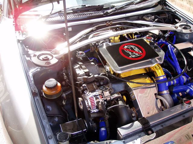

its no clipboard,its a plate to stick on top of a chargecooler,same as my m8 did in this pic,his was a one off just cut from a sheet.

right,ive been and got the panel wipe and some new cellulose lacquer and gave it another go…if you reckon the 2000grit(on order) will mask the dust enough then i might be ok,sure looks good at the mo,its dam hard to photograph this stuff.
