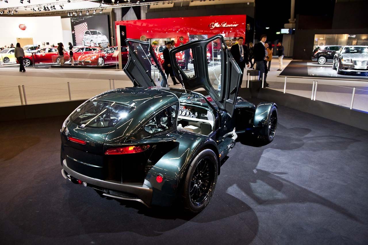

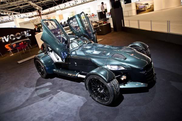

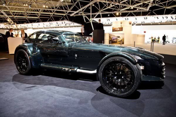

My contracts prevent me from sharing nearly everything, but I can share some presspics (from autoblog.nl)
So what are the composite parts?

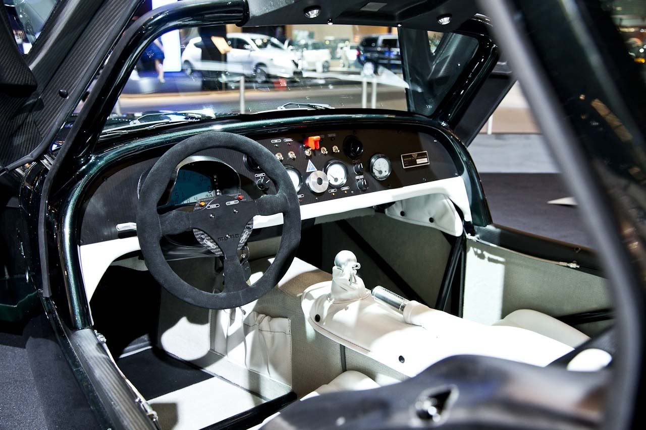

nose, sidepanels, cyclewings, scuttle, roof, doors, rear, chairs, dahsboard, some internal structures, and some engine dress up parts. All made from pre-pregs, mostly carbon fiber. indside parts all clear coated, the next will have clear coated sidepanels too.
Power: 270 hp audi engine
Weight: +/- 750 kg
Speed: faster than you dare ;)(estimated: 250+ kmph, 0-100 kmph in 3.7 seconds.)

I love the leather fancy luxury center counsel looking thing in the xxxxpit of a race car.

this one the most expensive, cheapest version is about 150000 euro
This one is based on the car that won the 24 hour race at dubai in the GT4 class. The carbon sidepanels are glued to the steel frame, what enhances the stiffnes significantly.
It’s based originally on the lotus super seven, so it’s a cousin from the caterham. The open version this one is based on resembles the lotus a lot more, but this one (and the upcoming GTO) don’t share much but the idee from that car. There is a lot more coming, but I can’t share that (yet).
For those interested, this one is called the D8 GT, the open one is called the D8, and the new will be the GTO. All Donkervoort .
