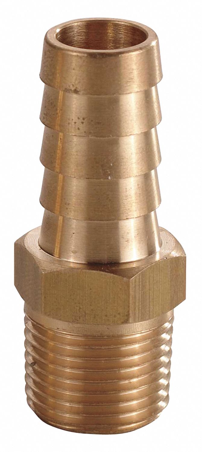

What type of connections are you using?
Something similar to this which was put into the PVC (tapped, tightened in then siliconed around for air-tightness):
