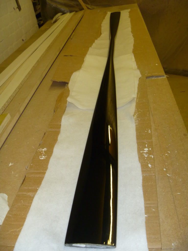

I used the Meguires Velocity liquid release system for the first time on my paddle plug yesterday. Having used both Frekote and chemlease in the past. I wanted to try something a little more user friendly without stinking out the shop and having to wear a respirator. Pleased to report the Meguires is odorless and has worked well so far with the epoxy that I use at ambient temperature. Will be trying a elevated cure cycle next week with it.
