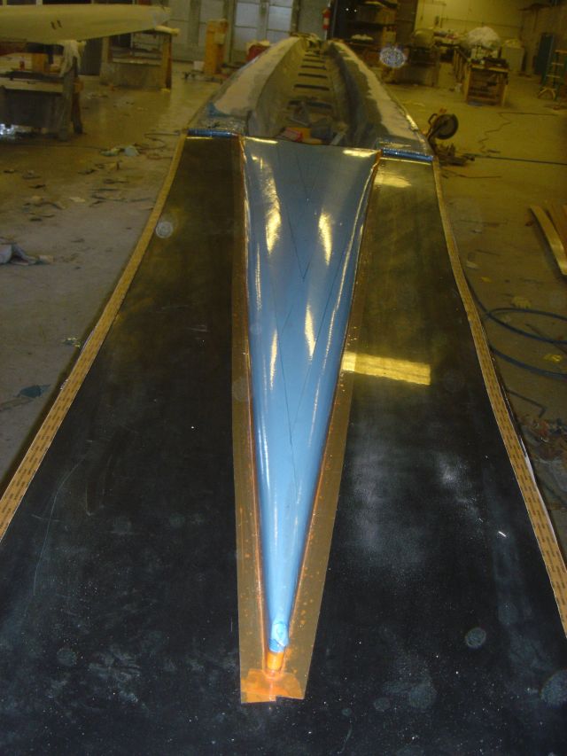

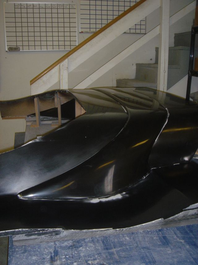

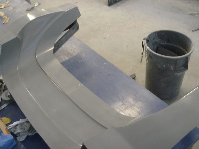

hojo, that is one stunning mold, fantastic job. I too use a MDF for some of my plugs, then spray with Duratec. You are right it`s time consuming but does produce a much better more stable plug. Just curious how did you join the two halves of the spoiler?
Baz
Fantastic work. That mold better see some pulls to make it worth it.
Thanks, fortunately all the materials used were free except the hightemp epoxy gel and resin. The mold is built from solid carbon, about 5mm thick, with a carbon/balsa back-up structure.
I joined the halfs by buttering both halfs with a epoxy mixture of micro-balloons ,cabosil some small chopped fibers. then after I glassed the out side seam with a couple layers of 120 glass to keep any cracking from happening. Ideally it would be best if I made a tounge on one half of the mold that would create the over lap on the inside of the part, it would makee the part lighter and stronger, but I never got around to doing it. as you mentioned it is time consuming, but I enjoy taking my time on projects and making them perfect. MDF is the funnest material to work with in my opinion. its really amazing what you can do with this stuff

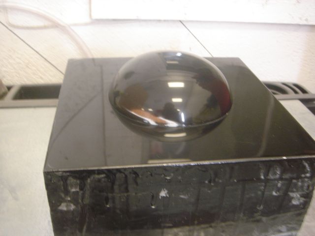

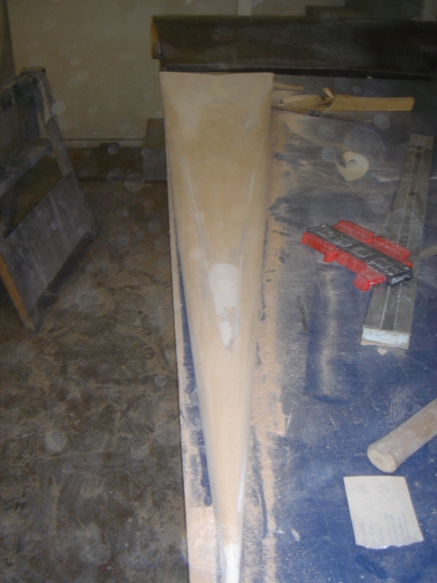

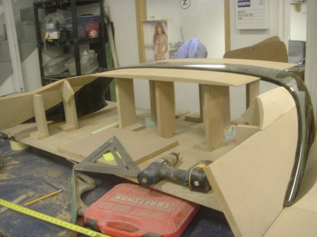

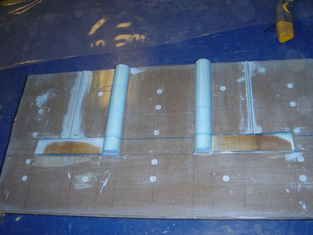

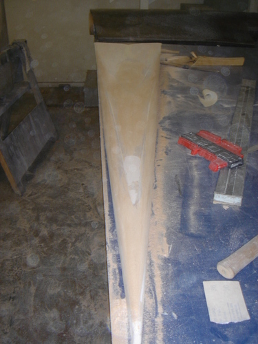

here some more stuff I built with mdf:

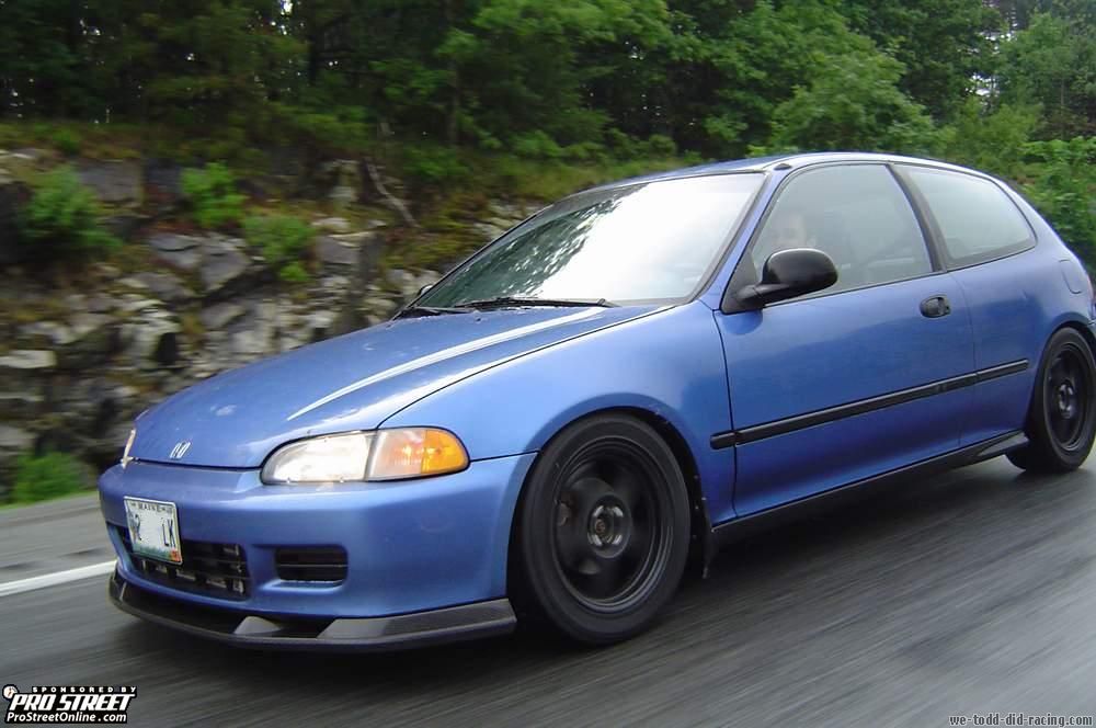

this was my first original part I made about 4 years ago, a lower carbon fiber lip:
