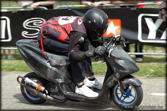

130 km/h in about 6.8 seconds. Faster than most cars.
the whole thing weighs 38.5 kgs.
I did advise in construction. The owner/rider hadn’t touched composites before. He started with some flat panels before making small parts. For the big rear part I had to help him a bit though.
I did the lay-up, and some laminating(the visible layer
), and the bagging and post cure. The rear part weighs 1100 grams, and has some SAN foam in it, as well as uni an biax layers.
