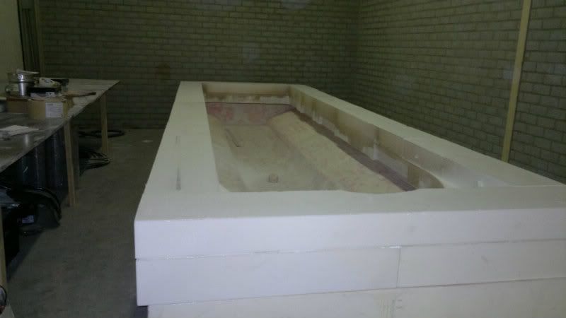

Build out of a (poorly) cnc’d mould.

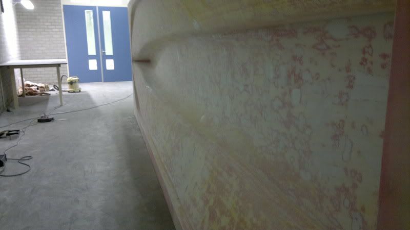

Start:
Needs some fairing:

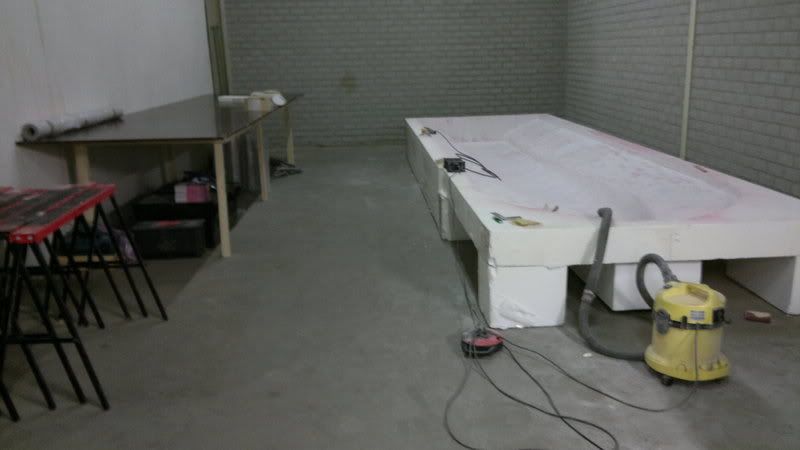

Good working positions for good health and good quality:
