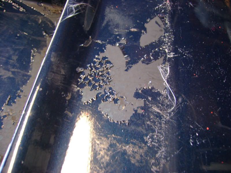

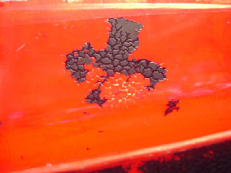

So F-ing pissed! Part 3!
OK, hybridracers must have jinxed me with his alligatoring gelcoat!
I’m not sure if this is alligatoring or some sorta chemical reaction. The paint and clearcoat was actually pulled off the hood. Not even my paint stripper could do that with as much ease! The paint/clear is a couple of years old.
Tooling GC was sprayed on. 1st two coats were lightly dusted, about a minute or two between coats. Then progessively heavier coats were put on. Mold release wax was used, tooling GC was less than a couple of months old. MEKP was 1 to 1.5%.
The problem started as soon as I began to lay down the veil, I noticed it at the other end of the plug. I knew it was F-ed already but just decided to continue on. Maybe some Duratec can fix the mold?
I still need to do the other hood vent…but am gun shy now, don’t wanna F-it up. Just what I need, it’s gonna take me a while to repair the hood too. I think I’ll just overlay it in CF.
Would that be caused by some seeerious shrinkage?
That’s what it looks like. But the first couple of coats were already curing by the time I finished cleaning out the gun. The upper layer of GC must have been damn hot! Even with 1-1.5% MEKP.
I don’t know what the thickness was, my barrel-type mil gauge starts at 40mil and never came close to that mark.
This sucks. And spraying gelcoat sux, I’m constantly cleaning the gun in between coats, no time to rest!
Rez dont get down hearted M8 i should think most of us have been through the learning curve. After you waxed did you not use a mold release agent like pva or ptfe, really needed especially on paint where your maybe unsure what it is. I would start again with a new mold, youll be ther forever trying to bring that back and i wouldnt think you`ll be happy with it.
Baz
So PVA would help? The wax I used was Kleen Kare Mold Release Wax or something like that. I’ve read a lot about PVA causing surface texture problems etc.
Couldn’t I just spray the mold with Duratec surfacing primer?
Rez, the problem was you had a paint of unknown type or at least you didnt know how the gel would react with it plus all the time invested in prepping the plug for the mold, so in this case it might have been prudent to do a test patch with the gel coat on the plug or PVA the plug or even both. I rarely take a chance on a new plug so most of the time and especially on a complicated mold i will use PVA or PTFE mold release agent, i will wipe it on with a lint free cloth or sponge but only lightly, you dont really need too much. And as for a texture on the mold surface from using one of these release agents no way in fact it will not be a texture unless you spray it on. Most of the time you are going to inspect the mold and do some finishing work anyway. On uncomplicated plugs where i have used a polyurethane or polyester to coat them with and the finish is like glass then yes ill wax them and mold from that without additional release agents.
Yes you could use surfacing primer on the mold but the hours you`d spend getting as good a finish as you could a plug, is it worth it i would cut my losses use the surfacing primer on sorting the plug and make a new mold.
Baz

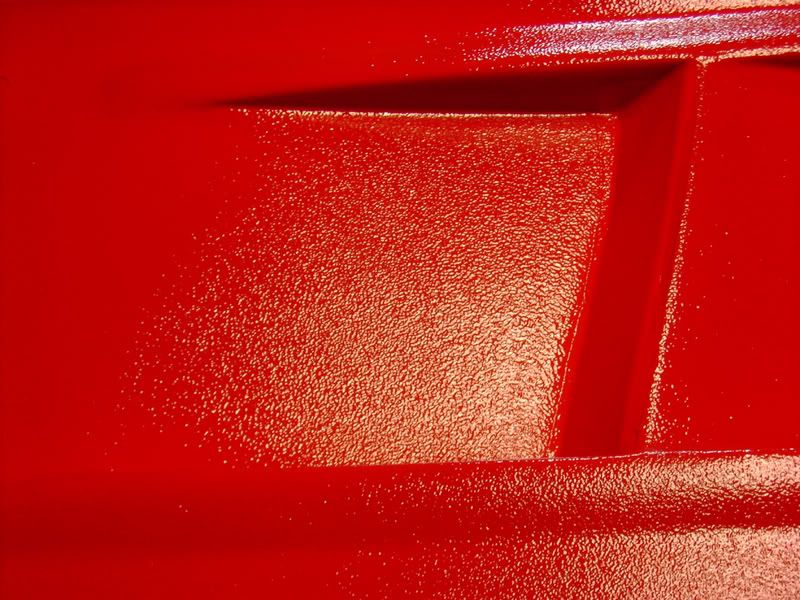

Man this PVA is hard to apply…now I remember why I don’t like it. Too little and the cloth drags and creates crap like gummed up sandpaper. Too much and it gets all bumpy.
What do you think, too thick?
No matter what, I get streaks. A light mist of water spread it around, but is that getting rid of the PVA? Or just spreading it thinner?
can i ask, why are you brushing!?
use a HVLP mini gun from Harbor freight. .8? tip? or .6 i believe. water it down a TAD! … i didnt water it but sometimes i hear it helps. spray the sucker on, wait, spray, wait, spray, wait, spray! 3-4 coats till u see nice film. DO NOT apply heat or air. the faster it flashs off, the more lines ull have!!! if u let it dry by itself, it will smooth out. :wink:
