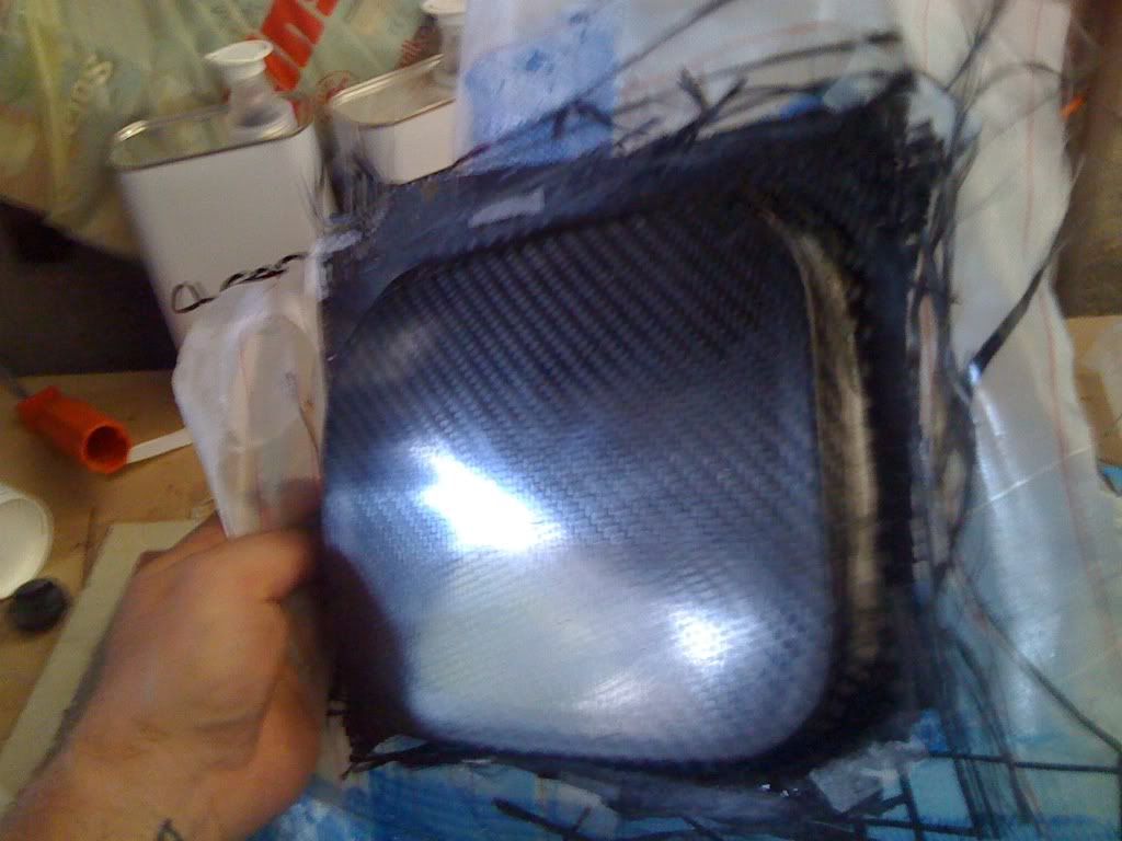

De mould. No pin holes, im a beliver in matte finished moulds or mould finished in p600. No need to polish if its getting a clear

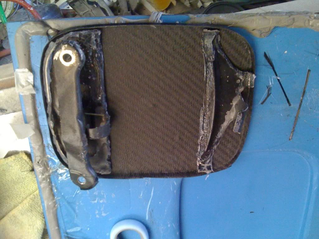

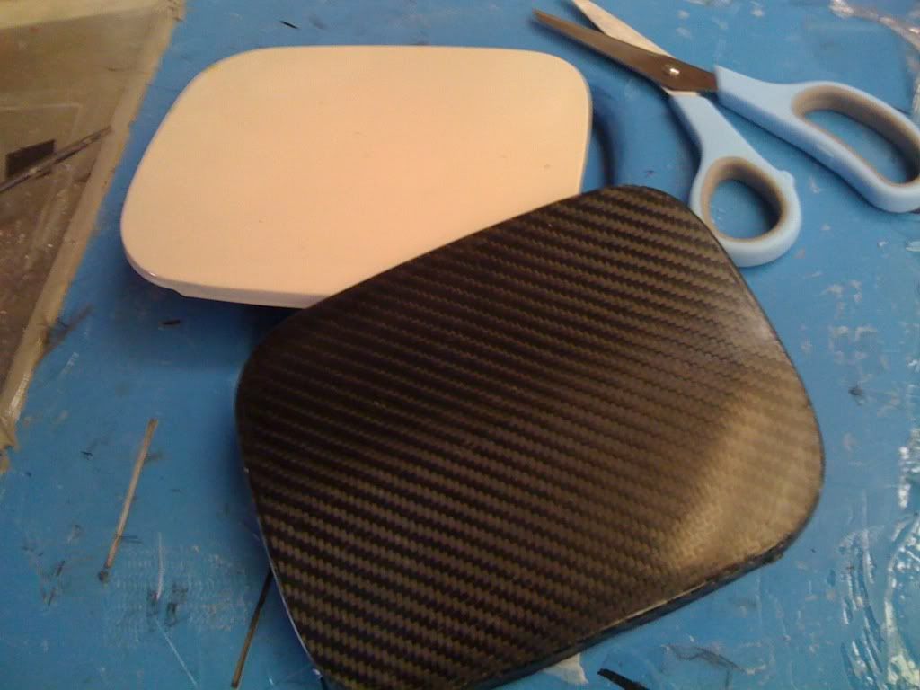

Trimmed and catch and hinge positioned

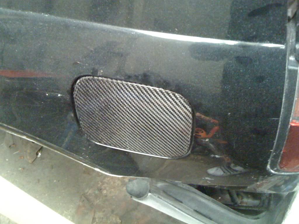

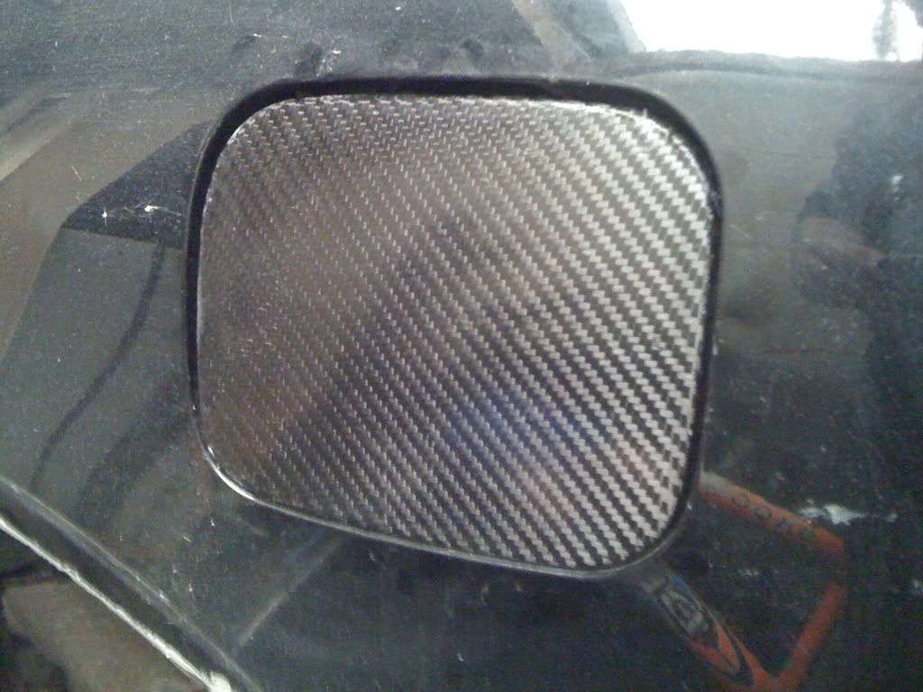

Test fitted ( not with hinge fitted )

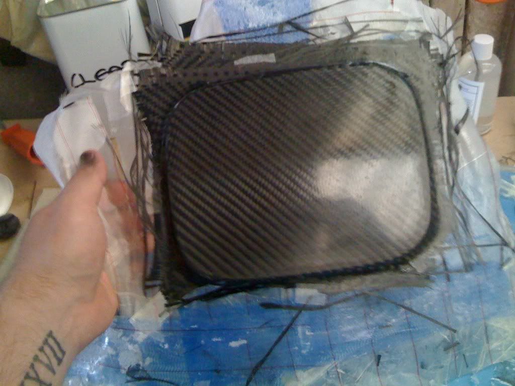

Clear coated
Clear coated
Nice job. Was this bagged or infused? What is your release of choice?
It was infused. I just use tr mold release works for me 5 or 6 aplications
Did you use the MTI hose for the infusion? I thought you got a sample.
The TR wax seems to be a popular choice for many pros. Every boat factory I’ve been in uses it for their molds. Have you tried other waxs and not like them?

where do you get your tooling epoxy? and what clear coat do you use?
Its not tooling epoxy and belive it or not im using a west systems, yer i got a sample but iv been making production molds since i got it, this was infused before hand
Sikkens superior clear

How are you making your moulds? What products and where from? I’ll have to try aerosol clear coat as I don’t have the equipment to use the sikkens, unless it will go through an airbrush?
I’m using tooling epoxy from easy composites.
Im using vynal ester from a local fibreglass supplies
You can shoot a medium solids clear with urethane reducer through an airbrush.
