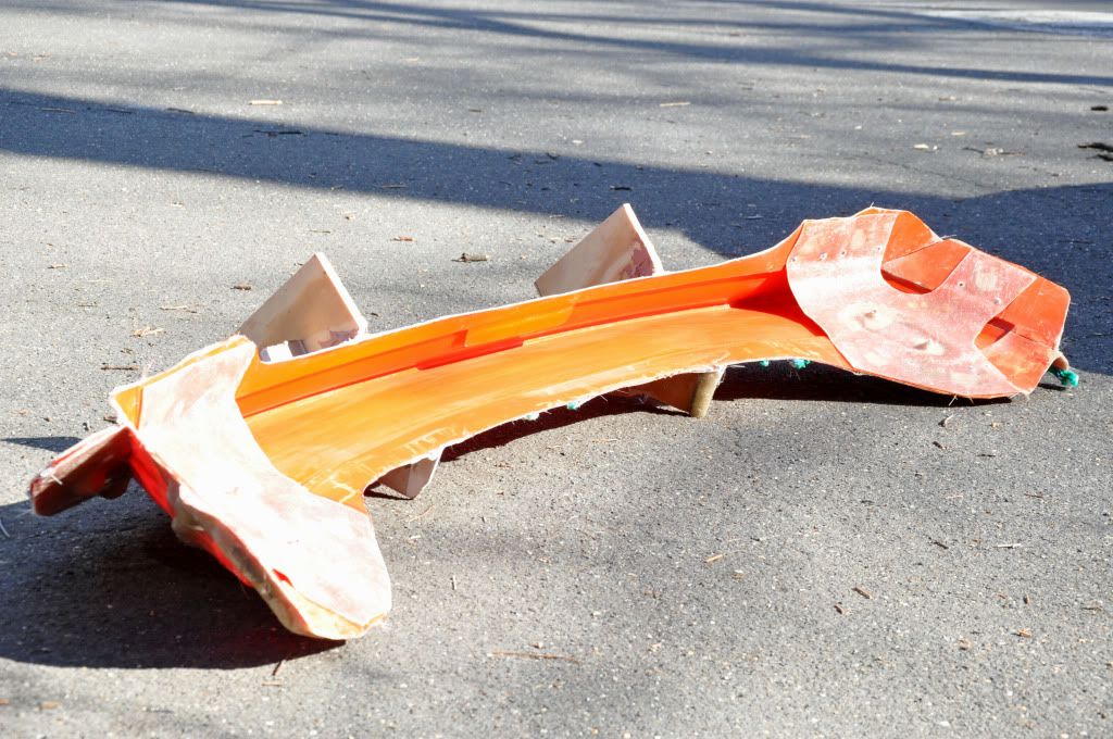

Over the past two years, I have developed a rear spoiler wing for an rsx:
negative mold locked together:
negative mold all apart:
I want to first try casting these out of hand laid fiberglass.
I lay them up with the two large halves bolted together, and then lay up the mounting pods seperately and then pop the pods into their registered spots, wait for it all to cure and them take all the molds off.
As you can see, I never have any trouble with the tooling gelcoat, I brush it on and it works great everytime- even in colder weather.
My problems always begin when I am starting to cast the spoilers from the mold.
First problem is this white gelcoat I have been using. I dont own a compressor or anything like that, so I brush my gelcoat on using a foam brush…which actually works well and does give high and low areas which a normal bush gives off.
I then wait for it to get tacky, no fingerprints and then usually start the laminate layup.
I have a friend who said I should try and laying down a later of just resin and letting that cure to put a barrier between the gel and the laminate, buuuuut I was hard headed and was rushing so I started with the laminate right away.
As I started to wetout the fiberglass, over time I started to notice that the white gelcoat would come off on my brush and in tighter areas I could start to see the orange showing through from my mold. What causes this? xxxxty quality gelcoat?
My other problem is the lamination of the tight rolled edges around the perimeter.
No matter how many times I go over the edges with my brush, and corner roller, the glass just ends up pulling away from the tight edges, which I know will leave me with brittle air pockets that will just break through after the part it removed from the mold.
Also, I find that white gelcoat is very hard to see air bubbles and such when laying up on top of it, compared to orange or black gelcoat.
