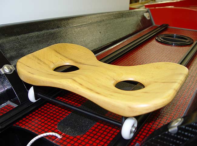

I dont think its prepreg. to me, it looks like they used the tube as a mold then layed up with-out bagging or peel plying, leaving a lean resin content. it looks almost the same as the rowing shells made by BBG, a germany company.I have seen these in person at durham boat company in NH. they are a hybird with honeycomb core, very nicely built. These may have been bag with bleeder no peel, but I have seen other boats that have not bagged and had this look. heres a photo
