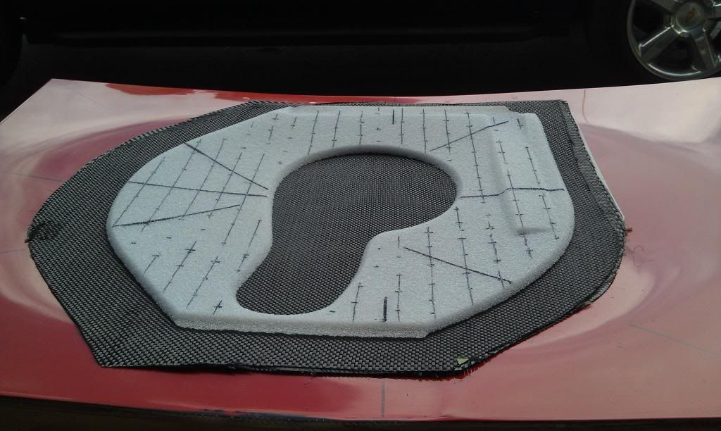

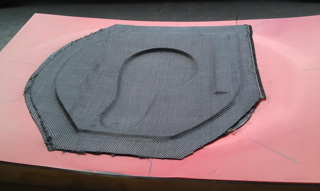

The stack for the part is: 3 x 5.7oz 2x2 twill CF, 1 x 5.7oz plain weave CF, 1/4" rohacell IG71 core with peforations spaced 1" apart, 1 x 5.7oz plain weave CF, 3 x 5.7oz 2x2 twill CF.
I also sprayed duratec’s VE in mold white primer before laying the first layers of CF.

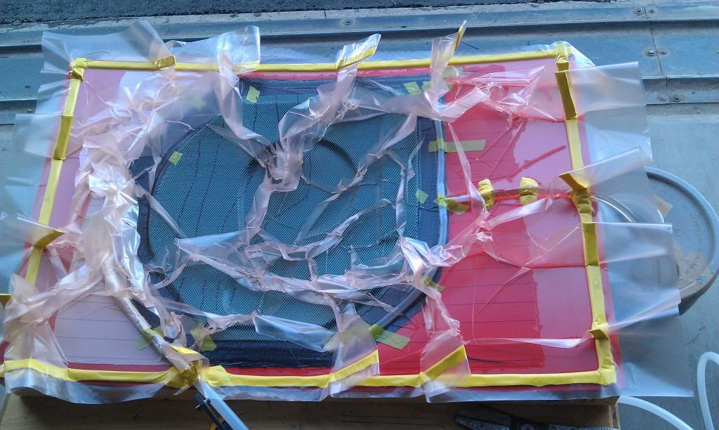

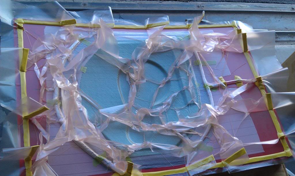

The part infused beautifully… cant wait to demold to see how it turned out!
Here are some pics:
