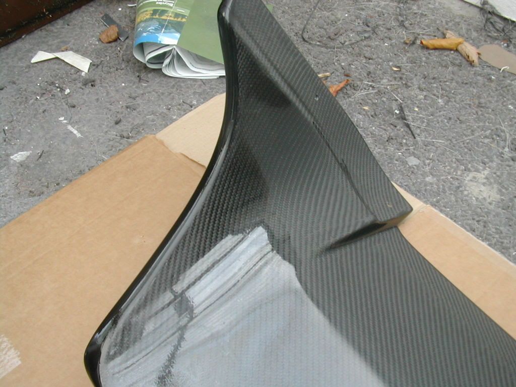

Heres a a few pics of some of the latest parts I have made.This is a replica of a livesports Toyota starlet spoiler
.Inside

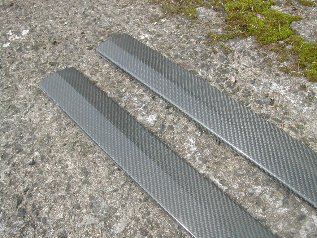

lower skirt trim for a makinen evo

Are those “rolled edges”? all of this was by infusion?
All parts have rolled edges where needed and were made with infusion.I use a low viscosity vinyl ester resin and clear coat all the parts with standard 2k clear.The spoiler was a bitch to bond togethet as the carbon laminate was so thin it was like trying to bond card edge to edge.This was my first attempt at a 2 piece part so next time I will build up more layers around where it will be bonded to give more thickness to work with.

what did you use to joint the spoiler?
for the actual joint I used a fast setting epoxy glue and about 20 clamps!.I also used some sika 255fc inside the joint to be sure.It was my first attempt at a bonded part and I will do some things a different way next time.
