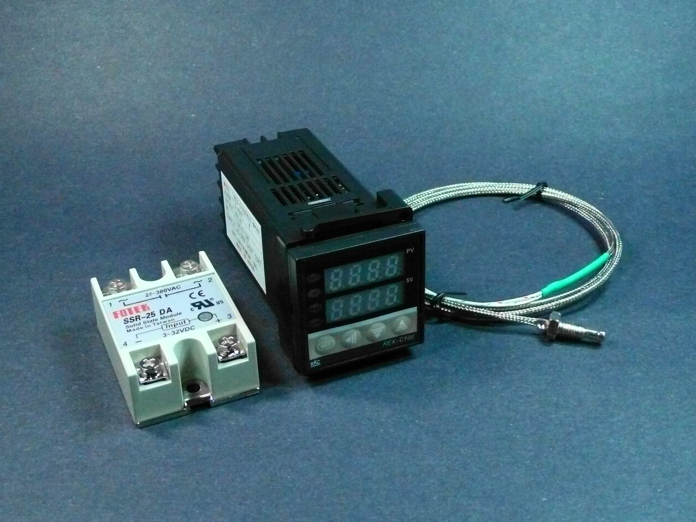

Can someone school me on oven controllers? Which of these do I want?
What’s the difference between them?
Are they junk and should not be used?
Will either one of these work for controlling temperature ramps?
What would be acceptable if not these?

You don’t want any of them. Do not safe € or $ at a ramping controller out of china. Most of the time it’s crap. Go for Auber if you want a cheap and reliable ramp PID. If you want high end go for Watlow. You can also find them for under $100 on ebay.
Thank you for your reply. But I’m kinda a novice. I’m using standard oven it’s a 220v powered. How do I choose the correct one? I just need simple ramp/dwell controls nothing fancy. Again thank you.
Your welcome. http://www.auberins.com/index.php?main_page=product_info&cPath=1&products_id=4. It is the same as I’m using. Works great and is very cheap. Buy a SSR with it on the website, they also sell on ebay. How many Watts are you using ?
Oh boy. I don’t know. But that says it’s for 110v I know the oven runs on 220v. So don’t think this will work. Unless I’m not understanding something.

Well. I finally got around to getting it together. It turns on, seems to work.
I still have to get a fuse for it. I also don’t really get how to program the PID. I also don’t get the heatsink thing. Is it supposed to go on the top of the SSR? Then the plastic cover over everything?

about the heat sink, it needs to be connected(to the SSR) to tranfer the heat. There probably needs to be/is reccomended to be applied a special paste too.
Yeah. Ive got some paste and some different heat sinks to choose from. I was just curious as to the attachment point, the top side, which is plastic? Or the bottom flat which is metal. I’ll post a picture of my mounting later.
Sent from my SAMSUNG-SGH-I747 using Tapatalk
It has to be mounted on the flat metal back side and don’t put to much paste on it. After that you mount the headsink on something else.
