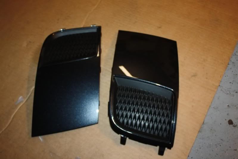

The part I am working on is below.
I’ve posted pics, but it needs to be approved.

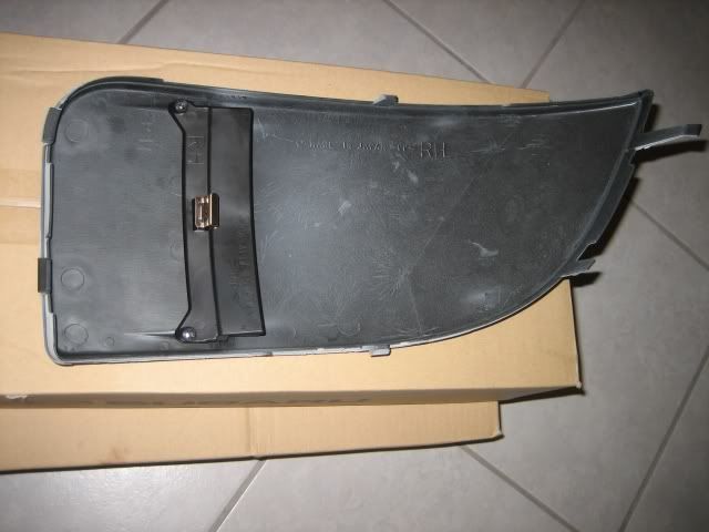

But when it is, those are the parts I am working on, in the end I would like to make a mold. Not for profit, but for my own use. I would like to make a full carbon fiber fog light cover for my STi, but the rear clips looks tricky.
I may just cut them and some how glue them, the passenger cover would have a duct that leads to the intake. Still working on the shape of the duct and such. Should be interesting and fun. Alot of cursing and frustration, but fun.
The parts can not expand much, so I would like to make a mold. Any suggestions?
On the overlay I’ve had to sand through the fiber and into the plastic on the edges in order for them to fit into the bumper.
