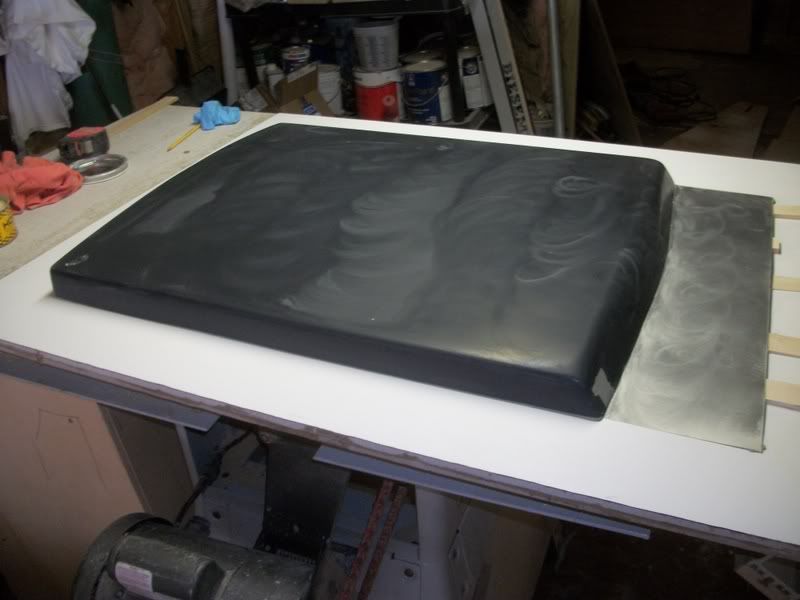

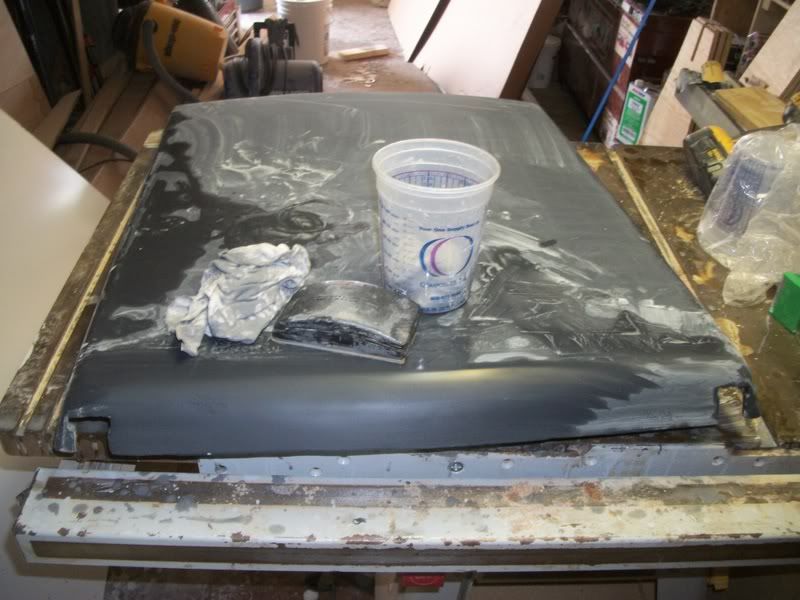

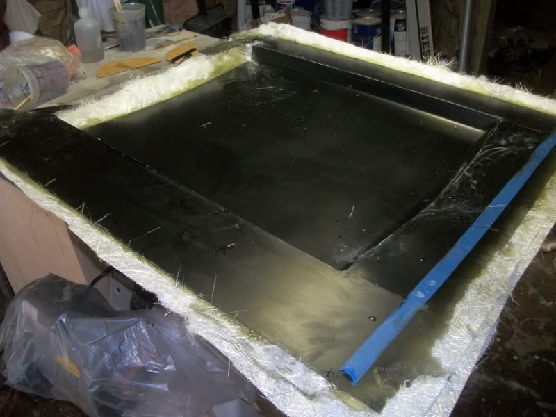

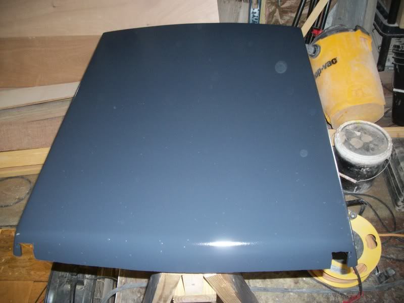

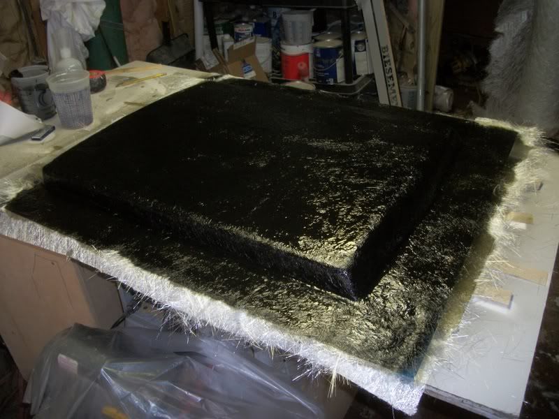

Thanks for the help guys… Built the mold.
