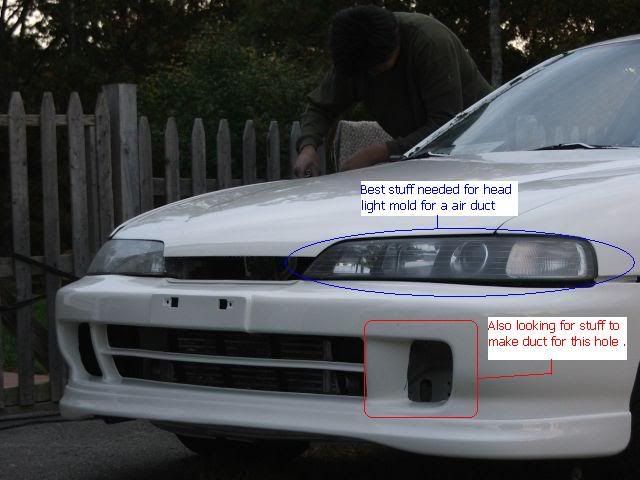

I am a newbi I never made a mold be for but I have worked with fiberglass and a little of carbon, Just used something that already exsited and alot of over laying…
Well here it is, Im looking to make two plugs, not sure what to use. They also make a mold for the passenger side of my front bumper theres a pic. I not sure it i like it being on the out side covering the bumper like that.But if some one can guide me in the right direction of where to start and the best material to us on going foward on make the plug. Thank you.
I have made a mold that I think is simialr to what you are wanting to do with the headlight. Mine is for a twin turbo supra, it will duct air directly into the turbo at the track. What I did was completely gut a headlight down to the plastic shell and then start filling it with Duraglass and sanding the shit out of it, for probably 80 hrs to get it just right. Then I sprayed it with Duratec primer and polished it.

Thanks. That thing looks nasty I am trying to do the same also, I have a top mount maifold with the turbo right behind the left head light n just trying to feed it air at the track. Im not sure how easy it is to get a JDM Integra head light. But ill will search. Now anything about the lower hole?
you could also try to take a mold off the back of your headlight for a starting point. It really wouldn’t need to be that great, just something to get you going. As long as you are careful a to protect the headlight you shouldn’t hurt anything.

try and find an aftermarket jdm headlight. OBX had them at one point
Yeah, if they have them aftermarket that would work perfectly. If you want I can check and see if they are available from OBX, I own a performance shop so I have lots of wholesale accounts and I think I can get OBX.

Thanks Every bit of advice helps me alot…I am going to try using the back of the head light. .I was thinking along the lines of making a frame of the back side and the going from there…Maybe cardboard or some along that line?
