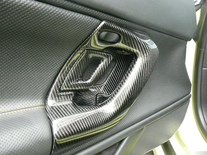

Hello guys can someone say what kind of resin is this? they say its like acrylic but what type? whats the name? and company that do this give 2 year wariatty of sratches and chemical resistance.
or this can be done epoxy polished and thats all?
I think it’s an acrylic clear coat, the resin may be epoxy or vinylesther. And 2 years warranty on scratches
Does epoxy get that clear or is it more cloudy, I currenty use Simlar 249 polyester resin to have a crystal clear finish. Im new to all this so correct me if Im wrong
There a quite a few epoxies that are clear.
but if to polish epoxy that can go very bad? what you think? also how they can give 2 years?
