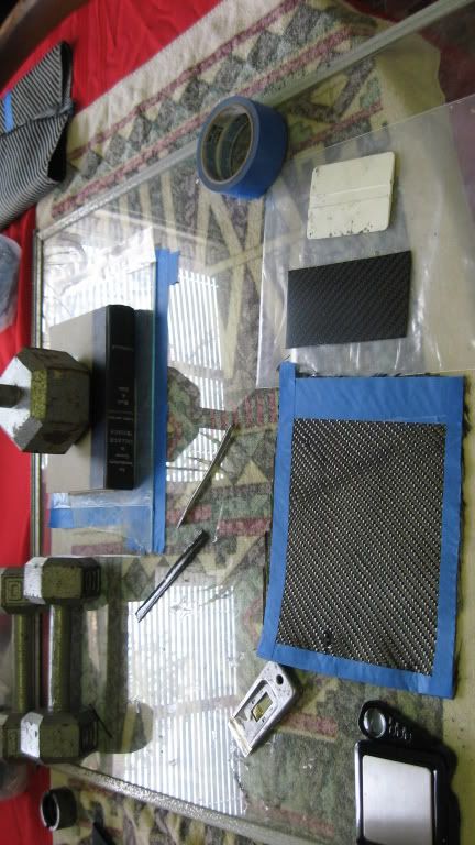

My first attempts are just flat CF plate made on a piece of windowpane and I used Meguiars Carnuba car wax.
My super simple and cheap setup:

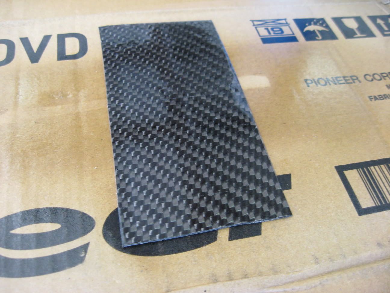

I played around using multiple layers and made a few plates with 1 layer of CF and 3 layers of chopped strand mat. This stuff is strong! Here are a few of my first pieces:

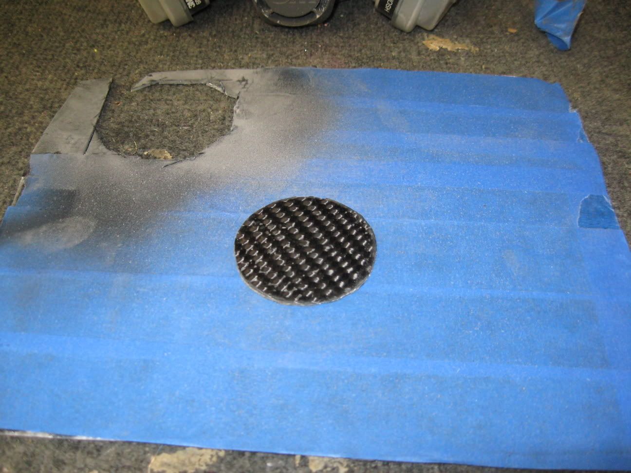

To cut out circle disc…what I have done before (but it takes practice) is to use a hole saw without the center drill bit and rotate is backwards…
Thanks for the comments and for the hole saw tip.
I ended up using a dremel to cut out the rough shape (you can see the cuts in the picture), then hot glued it to a grinding bit. I threw that in a drill, and smoothed it out using some sandpaper. It’s not 100% round, but it worked fine for center caps.
