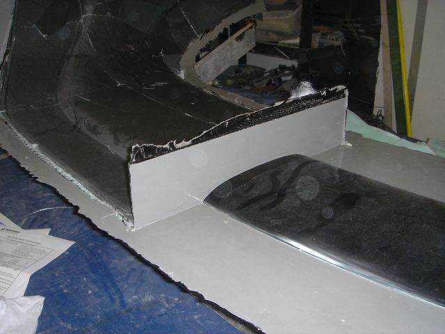

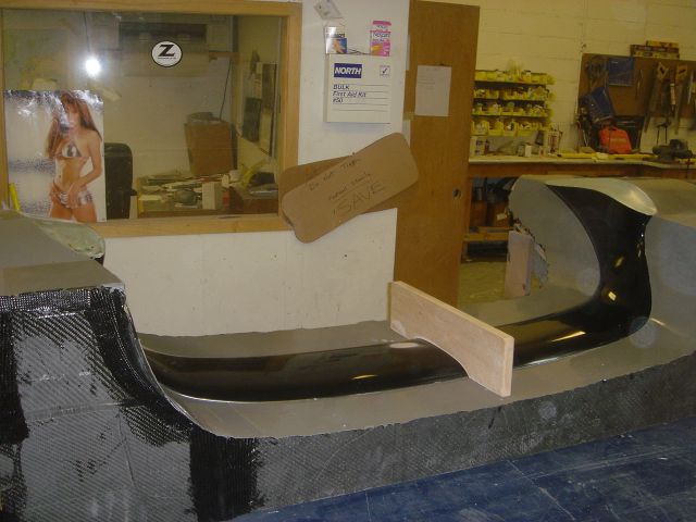

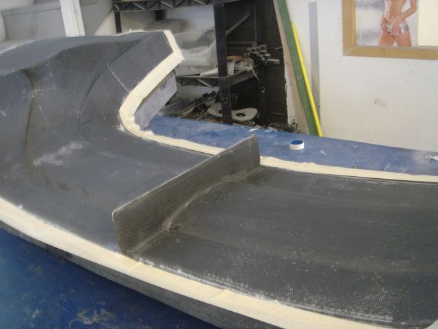

heres an example of a simple parting line I did:
^^ What parting line?? I only see the poster in the back!! :smiley:
looks good, what is that shiny grey material ?
aluminum filled high temp epoxy gelcoat
What properties does the Al give it? I guess you brushed this on?
it does well under many high temp cycles. transfers heat well. good for prepregs
