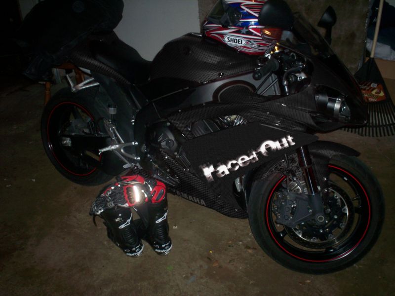

mmmm sexy i love the way carbon fiber looks on streetbikes
now thats hot!
Get some better pics, as its really very difficult to see very much in that one. But for cosmetic parts on road going bikes with black chassis, properly done silver Eglass might be well worth trying?
looks cool! is that your machine? did you make all the bodywork yourself?
As said, some clearer pics would be great, closeups too. I’d like to see more of it.
Enjoy!!!
only 5 more parts left to complete!!!

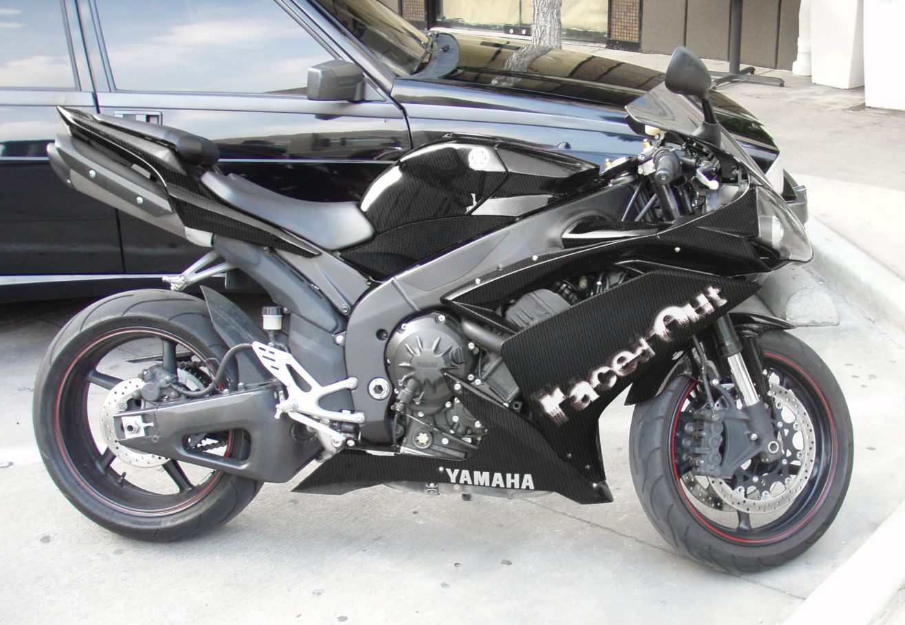

the resolution makes it look like a photoshop… can you get cloe ups of the mount tabs (headlights etc)
are you trying to pull a fast one on us:confused:
wait a minute that is a photo-chop
the lines of the weave are different and don’t match between pics…
also if you look in the reflection of the bike in the gloss of the car you can see that it’s a red bike…
what the hell?
compared to this one…
Lol…guess photoshop is easier than learning how to laminate properly though…
hey look classic bike is the only one good enough to spot it :stuck_out_tongue_winking_eye: yep never claimed it was the real deal…but yes photoshop for me anyways is easier lol then again im a pro with photoshop…this is the “concept” im shooting for with my bike, just waiting to find a stock upper faring and ill have all the plastics to begin mold work

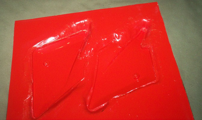

? who said i had a problem making parts? lol i do ruin about 1 out of every 10 parts and i think i have a good idea why, its my bagging technique…the bag film i first bought is .005mm thick and doesnt stretch, i think thats the main problem right there, i use double the breather fabric i should need to use in the tight corners and that takes care of the bridging sometimes…but 1/10 times i still get bridging, i oredered some stretchlon 200 and im looking to buy a REAL vacuum pump instead of the venturi system…i can only pull about 23hg with the venturi setup, obviously for bike parts that are really complex in design this just isnt enough vacuum to EASILY make parts…im constantly having to adjust the bag when im doing the vacuum stuff…just a hassle to ruin 1/10 parts, ive ruined about 10 or 11 parts now and its depressing sometimes
Multi stage venturi vac pumps are very common in heavy duty industrial production processes, work very well and dont have moving parts to wear out. However these wont be any good if you only have a small low powered compressor.
Regards your production process, I guess you have enough experience of hand laminating, to be able to make perfect moulds? If you dont have perfect moulds, then your finished parts will never be that great.
that i do have perfect molds :stuck_out_tongue_winking_eye: 1 of these molds has 1 coat of wax that hasnt been wiped off yet
For small cosmetic bike parts like that, you would probably find that contact moulding with modified poly resin, is going to be faster and cheaper than vacuum.
i will agree with that, i use polyester tooling resin and polyester tooling gelcoat, i dont put my molds in the oven so its not a big deal for heat right now…i started to put them in the home type oven at 150 and leaving the door open but i found a better way that im doing it now…i have these silicone heating pads that drape ontop of the mold and will heat up to 110degrees, they work PERFECTLY!, parts cure in about 1 hour
on the other hand i only use epoxy when making the actual parts, its the only way to go
