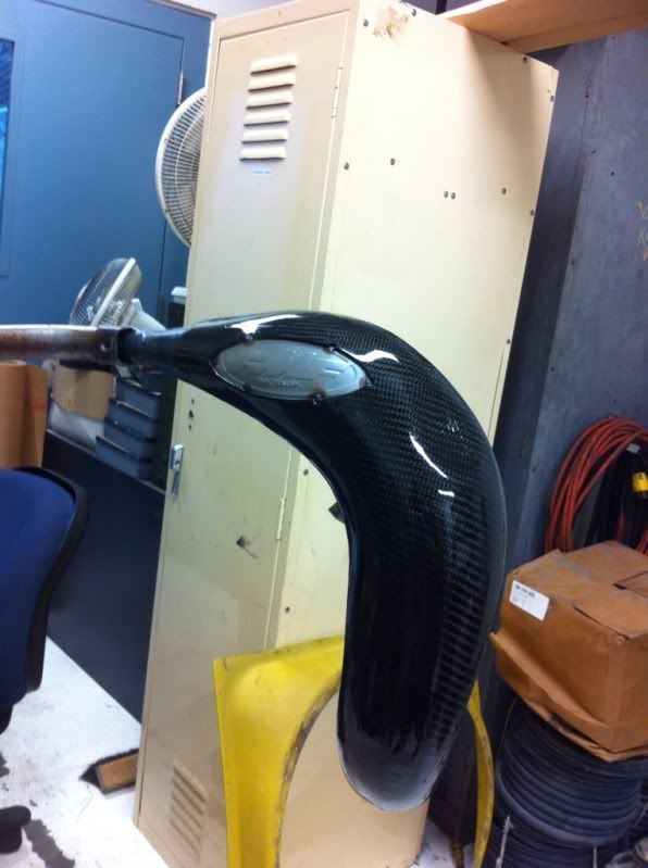

So I made one of these guards for a buddy’s 2 stroke. It’s a custom pipe so he can’t buy one. Anyway since its a one off I used the pipe as the mold. It’s all good to go except how would I go about getting the top layer nice? I’m bagging it and it turned out great so far. I was thinking of small strips of Mylar ect. Ideas? Thanks guys aloha
Oh and don’t really have time to clear coat ect.

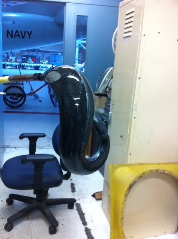

Well it turned out ok. Ill sleep good tonight considering it was my first try. And I learned some things. #1. Use real clear and not hardware crap. Lol I know you told me so. #2. Make sure your top layer has a thick resin coat.
