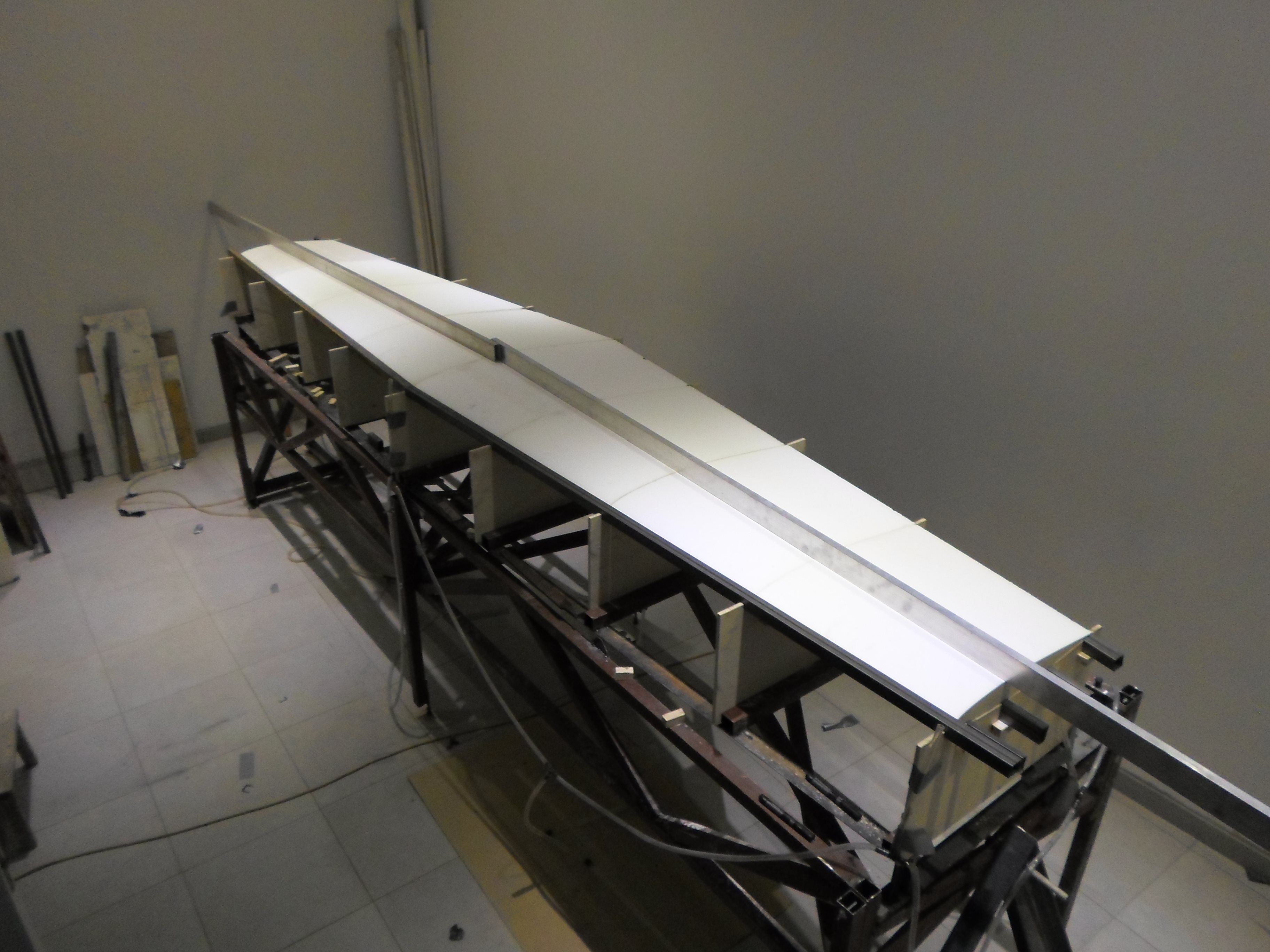

Do you have the shucks/beds that the cores were cut from? Were the cores hot-wire cut?
This is the setup and bed i am using. Overlapping four layers at the leading edge would distort the the bed form. Do you think that if I place the seam on the upper side maybe one inch back would produce shrinkage?
