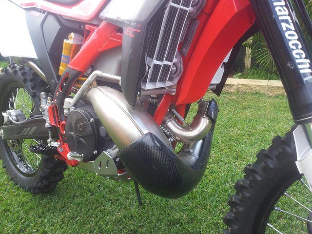

So in this application it’s a serious pain in the ass to bag, so in the past I’ve had great results using teflon coated fiberglass for compression wrapping. My question is which would yeild the best result… Laying and wrapping each layer. Allow to cure and repeat, or layup the 5 layers and compression wrap once. I’m thinking one by one would yeild the best result.

Like they say… A picture is worth a thousand words. So I’m laying the carbon on the pipe and using the teflon coated fiberglass to compress it down against the pipe. I’m thinking I will pull the teflon when it’s tacky but not fully cured and repeat the steps. The tackiness will help hold the carbon in place before I wet it out.
