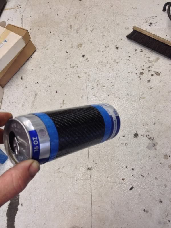

I’m not sure if it will work but wanted to hear your thoughts. Lets say I wanted to cover a very off shaped part. It’s just for looks. using 3m adhesive tack down the cloth. Then wetout the cloth and cover with Mylar.

Funny enough I found some 3m spray at work. Grabbed a redbull can and put the end in a vice. It worked so far. Ill see what happens when it’s cured
It worked just fine. I jyst slapped this on and my plastic had a bunch of creases and using a squeeze on a can… You guys get the point.
