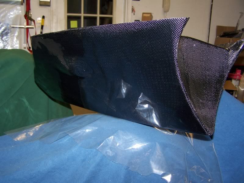

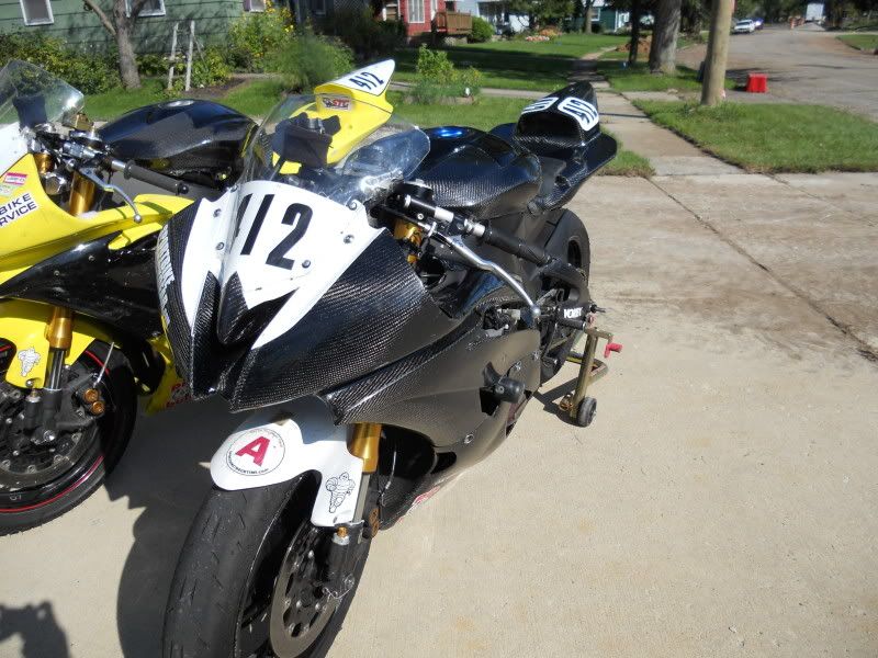

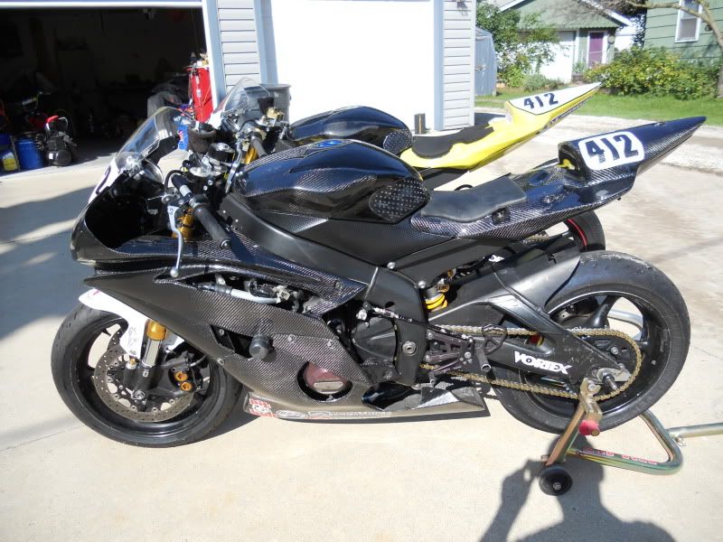

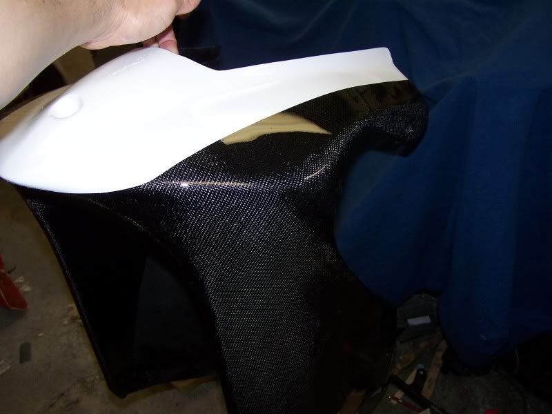

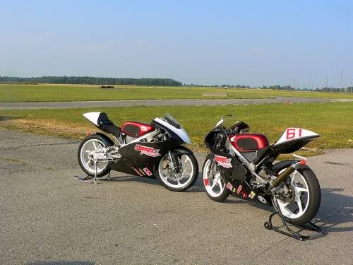

Made bodywork and a tank slider/cover for my race bike (R6). Nothing special, used infusion for all the parts with VER and and MF 105 catalyst (low foam) from Michigan Fiberglass works awesome, carbon/kevlar fabric in all the points that can slide on the ground. All single mold parts basically glued together.

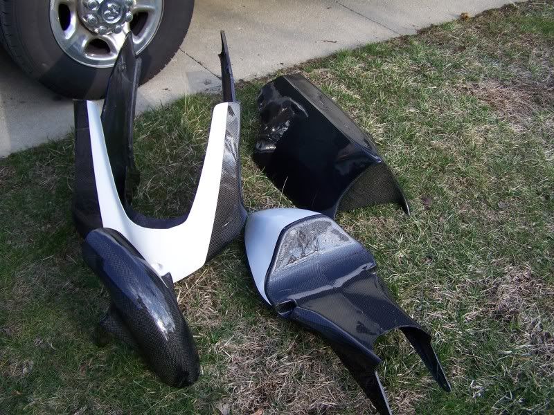

Same thing with the RS125 stuff. This came out at 5.5 lbs total for the set and held up great when he crashed.
Great looking parts! Keep it on!
