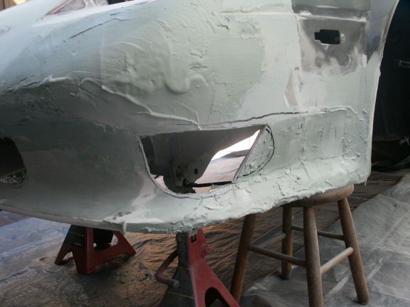

I was wondering also what else used apart from foam, what fillers ?
Heard there is plaster and bog ? any else ?
Also heard people use clay ?
For example what would he be using here ?
If you want to do it right, the way the big industry does it, you model it on a computer and machine either the plug or the mold on a 5 axis mill. That will get you around plus or minus 0.005" or about the thickness of a hair.
Bondo to smooth the finish after he has layed down some fiberglass
“Bondo” is MarHyde’s version on automotoive body filler: Polyester resin & fillers to make it a paste. You use it to fill the low spots (valleys) up the high spots (mountians), as that is how I discribe it in the classroom. Just like sanding the mountains down to the valleys…
The secret when using BONDO type materials is to let it cure to a “B” stage and then use a Shurform (cheese grater looking tool) to shape it and it then cuts like cheese. If you wait until it fulls cures (I see it on cars that are driving around too many times and cringe at the sight…), then break out the HD grinders and watch the dust fly!
