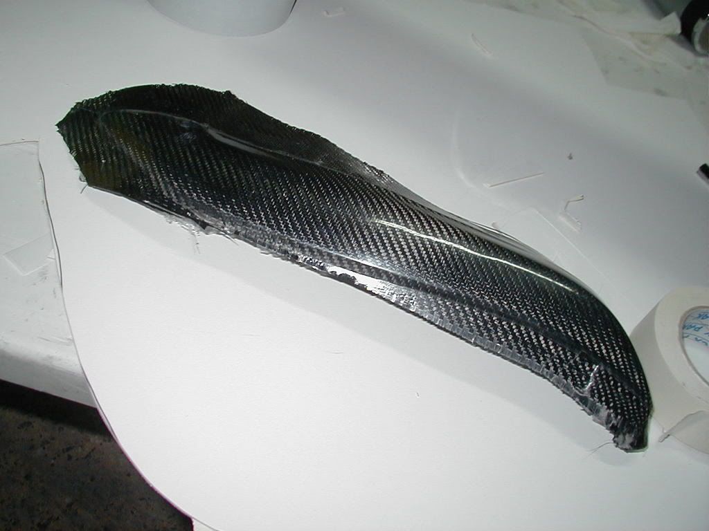

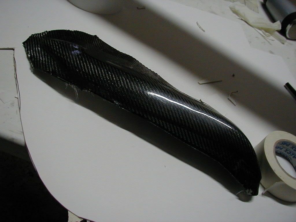

the pump i use comes from a big professional fridge so it’s very strong. The resin was moving fast, but when it reached the end of resinflow it stopped completely! i have used real thin epoxy with this kinda thing before but it kept going even after the resinflow mesh ended. i was hoping to slow down the process a bit this way so any air in the resin would flow away and the fabrics would be well wet… but instead i got the part perfect up to the resinflow, almost dry, and soft the rest of the way…
here’s the good side of the product, the rest i cut off and threw away…
