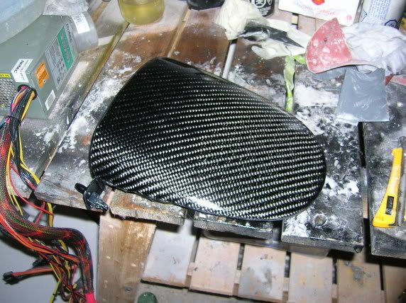

4SC, nice cf part. I am learning ( obviously lol ) how to lay up fiberglass parts, in fact am doing a rear seat cowl for a sportbike currently. I would consider myself a begginner at best, but it is fun work.
