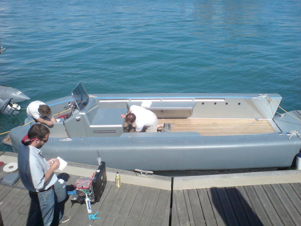

The carbon furniture was for Sir James Dysons yacht Nahlin, it was quiet a hush hush project at the time. I was helping with the building of its three custom composite luxury tenders and was initially in the frame to do the furniture as well. There was a fair bit of brainstorming on how to get round some of the design issues. In the end they moved the delivery dates forward on the tenders so we did not have time to do both and the furniture went to Nicholas who did a super job. I was really looking forward to making the furniture and was gutted when I found out it was not to be.
If anyones interested the three tenders were all ribs, a landing craft below a larger crew/passenger rib and a custom SOLAS rescue rib
