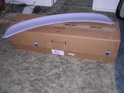

How difficult would it be for me to make a mold and reproduce this spoiler??? How would I go about making it since it is currently “solid” plastic??? This spoiler is no longer produced and I have someone willing to loan it to me to make a one off or possibly a few replicas…

It looks like it would take at lest 2x mold halves to make and to be able to remove the finish part.
But you would have a bunch of rejects as trying to get resin and reinforcement down in that little area (top of the wing) would be a Bitc-! Unless you added more material, before making the molds, to the backside for more room to lay that area.
If this would be your first composite mold / part…take it from a teacher of this stuff…start with a simple shape, one mold part to save you money and state of mind too!
I typically make these things using a clam shell mold or simply a two piece mold. Depending on whether weight is an issue, I use either a foam or liquid plastic core to fuse the two pieces together and finish the seam with black tinted resin. A final clear coat completes the project.

odd i am building a spoiler similar to yours ben! here are the picks of it as of to day note the divits in the flang!! these guys are corect very hard to build but i will help
