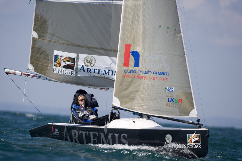

Stonecast 95PA
[ul]
[li]Crystal clear chemical resistant spray iso/npg gelcoat with excellent clarity[/li][li]Crystal clear chemical resistant spray iso/npg gelcoat with excellent thermal shock resistance[/li][/ul]Scott Bader do a clear spray gel coat called Stonecast 95PA its polyester based. It was used on the Artemis 20s several were done with carbon show hulls. Here is a pic Hilary Listers Artemis she is a quadriplegic and sailed round Britain in it. She controled the boat by sip" or a “puff” semaphore. These straws are connected to sensitive pressure switches on a computer, programmed operate steering sails etc. An amazing and inspiring achievement and a nice project to work on.
