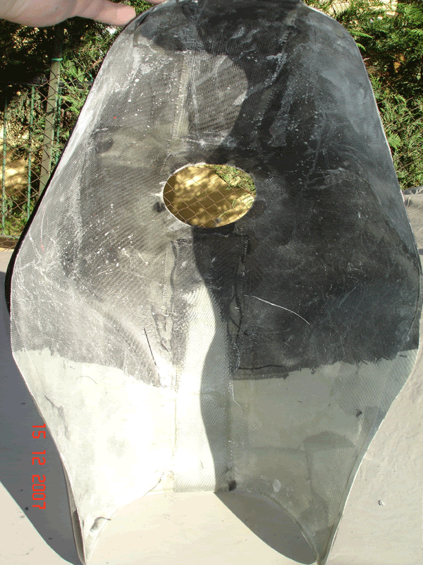

the last week I finished the tank cover panel for Suzuki Hayabusa. This is the first time that I make it and is of course much cheaper to sell it. The people that didn’t wont to buy full tank, this choise is the best, here’s some photos and of course I wait your opinion:
The photo above is the inside photo

george, does the shape of the tank not make it difficutl to get the cover out of the mold when it’s done? It looks like it curves back on itself…

The truth is that before I make it I was wondering about the size, you see if you make it exactly as it is then you can’t match it very well. So I decided to increase the tank for about 5-6mm more in the center of the tank. The results I can’t tell you yet, in the end of this week I will install it. So, will see

I use two pieces. First I finish the left side and then the other side. After cure I take them out from the mold and I make all the necessary cutting and sants. Then I connect the two molds again but this time with 5-6mm distance between them. This happen because we need to be more bigger than the original. Then I put again to the molds the already panels inside and I put some stickers in the cornet to keep them in the correct position.
Finally I put geal coat again to the mold but this time in the area of free 5-6mm space. After cure carbon and all the rest you know it.
