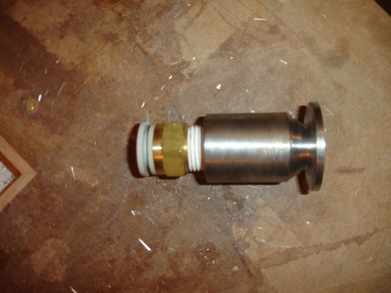

For the pump I create some stuff to make my life easier.

George did you make some pictures of the pump setup already ?
Or to busy with making awesome cf parts?
I made to lathe the following parts:
this is for pump
