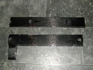

Heres a couple of new parts i did recently.They are spark plug covers for vauxhall 2.0 ecotec and 2.0 xe red top engines.Infused with 1 layer of 200g 2x2 twill and 3 layers of 350g satin weave.super light and stiff.

The L shaped one is the hardest to lay up.The cloth distorts very easily at the 90 degree part of the L.Doing some other vauxhall molds at the minute.Vauxhall stuff is pretty scarce in real carbon fibre.Was talking to a guy recently who was shocked when I told him the parts on his nurburgring astra VXR were fake carbon !

The parts were both resin infused and sprayed with 2k clear to finish off
can you post better pictures? :slight_smile:
