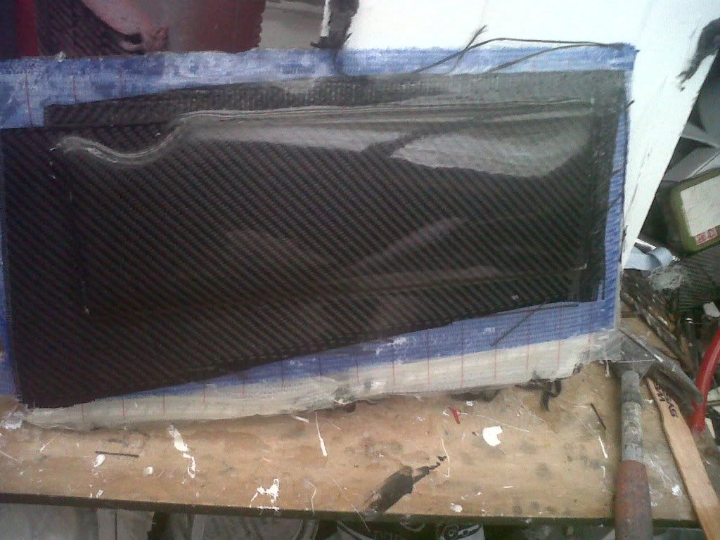

first infusion
well here goes…

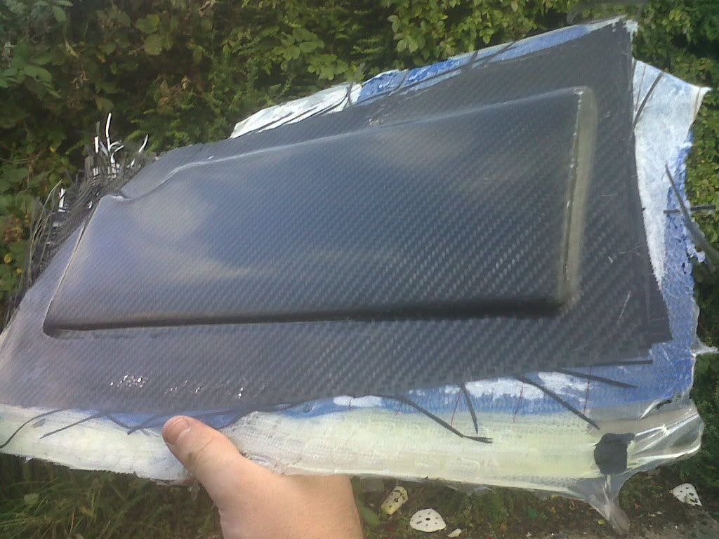

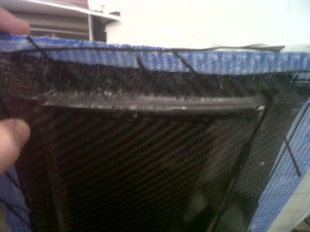

first part i pulled off…

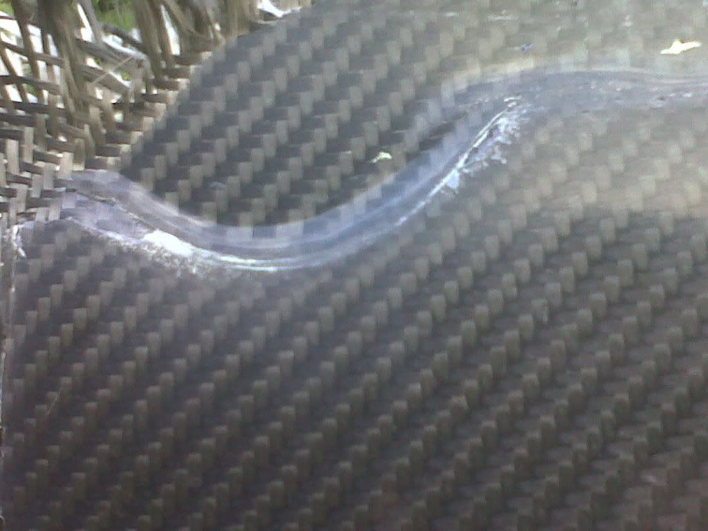

if im correct to cure this problem, i need my bag not to be as tight?
alsi om using a west system epoxy, it says to mix with a ratio 5:1 and id does seem to gel very quick i would be worried on a large part.:eek:

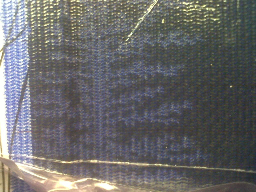

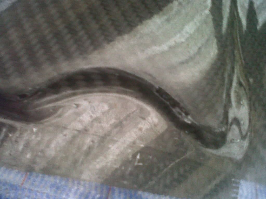

also, i got really worried because this appeard
i thought the part would be ruined but no?? it seem to happen when the epoxy started to gel. maybe because i didnt de gass it??:confused:

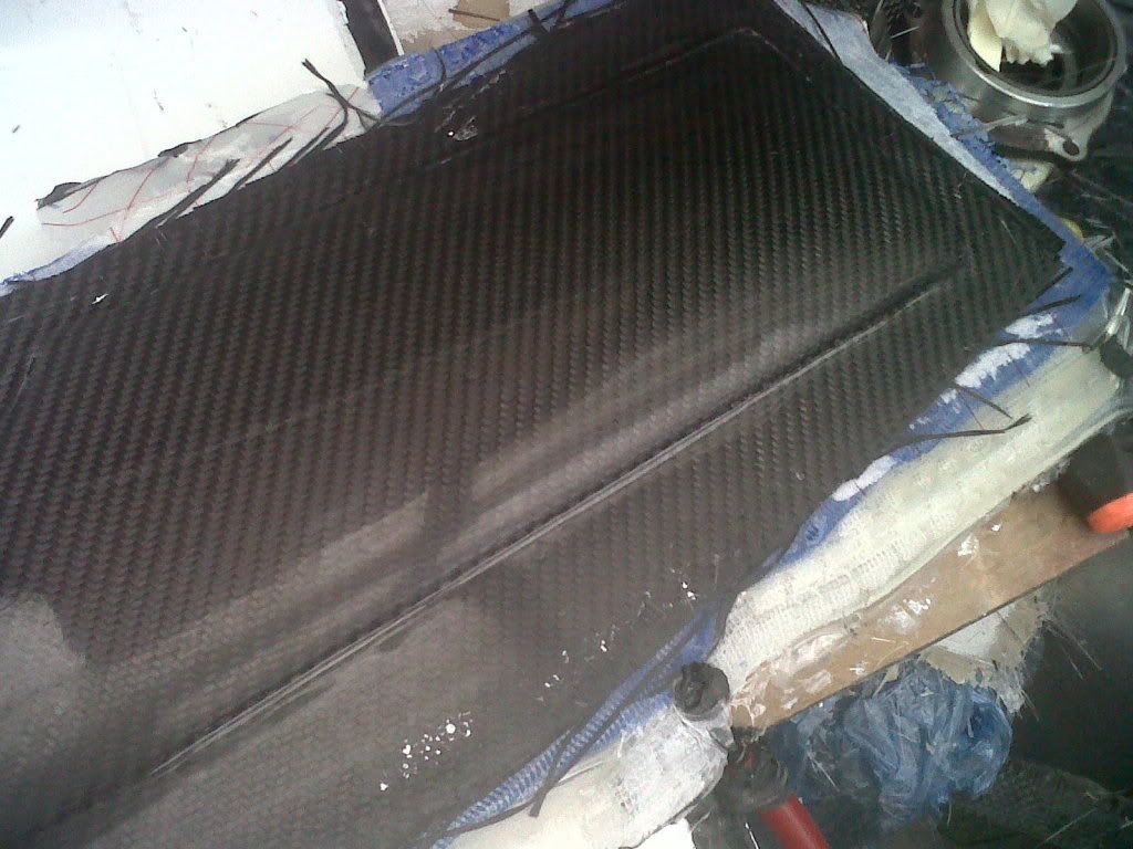

so overall im happy, need a baggy bag and maybe change mixing ratio. also add a catch tank. but im happy

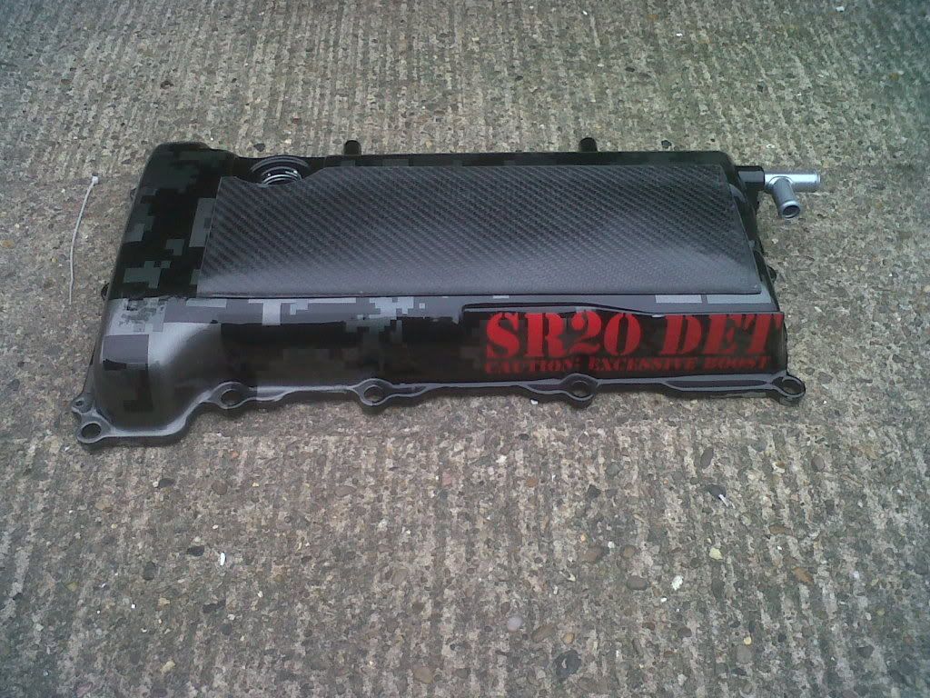

ready to clear coat :slight_smile:
Great job on your first infusion! My first didn’t look that good and they were sheets!! Sorry I don’t have an answer for you where you ask if the bag is to tight. I didn’t think the bag could be to tight from vacuum. :confused: I guess that’s why I’m still a hobbyist :blink:
material and or bag was bridging in the corners. best thing to do is control your vacuum, raise it slowly and press in the corners with a rubber squeegie. Also mix epoxy at exact mix ratio, do not change the ratio thinking it will change the cure speed. If you need more time use a slower hardener. Overall not bad for your first shot
The line bubbles in the blurry picture indeed are bridging. Take some more effort to place the fibers exactly in the corner. After pulling a bit of vacuum, take a plastic stick, and push the fiber in the corners. The bag can be extremely oversized, make sure it does not bridge anywhere. We want creases, no bridges.
The Christmas Tree shaped bubbles are air that was introduced through a leak. If you see this, chase for leaks. Best thing is to chase them beforehand, doing a vacuum drop test, and using a leak detector to find the smallest of leaks.

To back what others said. Yes, the bag was too tight in the corner. Release vacuum, push everything you can in that corner, pull vacuum again. Make sure you have enough material of course. Can’t push already stretched bagging!
The air bubbles in the flow media…which side was that? Infusion or vent? Either way, it looks exactly like an air leak.

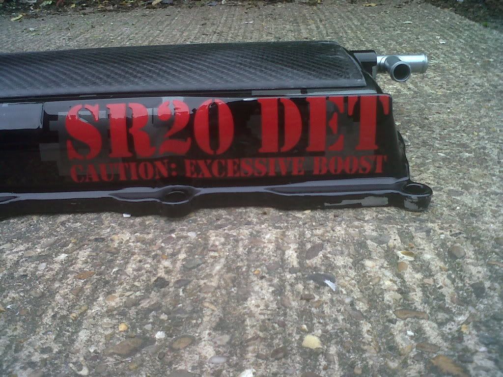

Nice, the “camo” paint I like aswell
