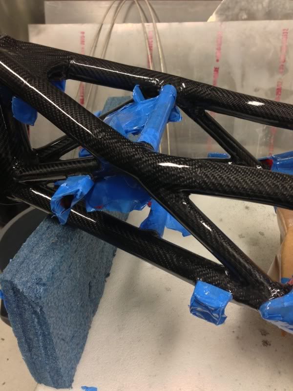

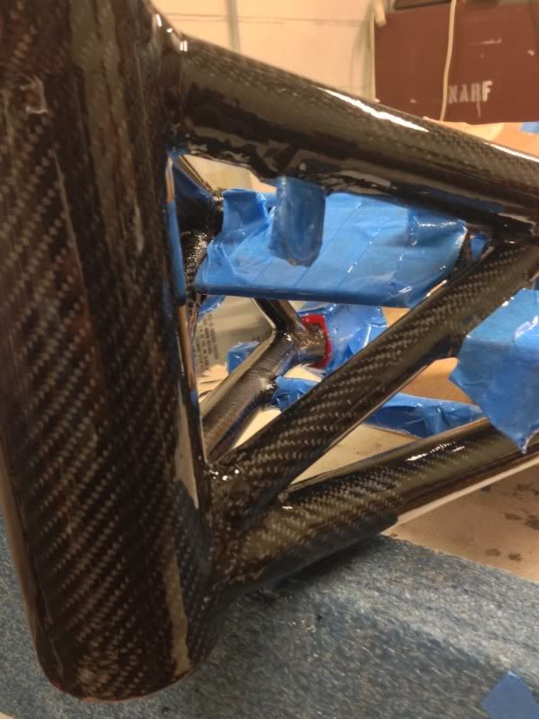

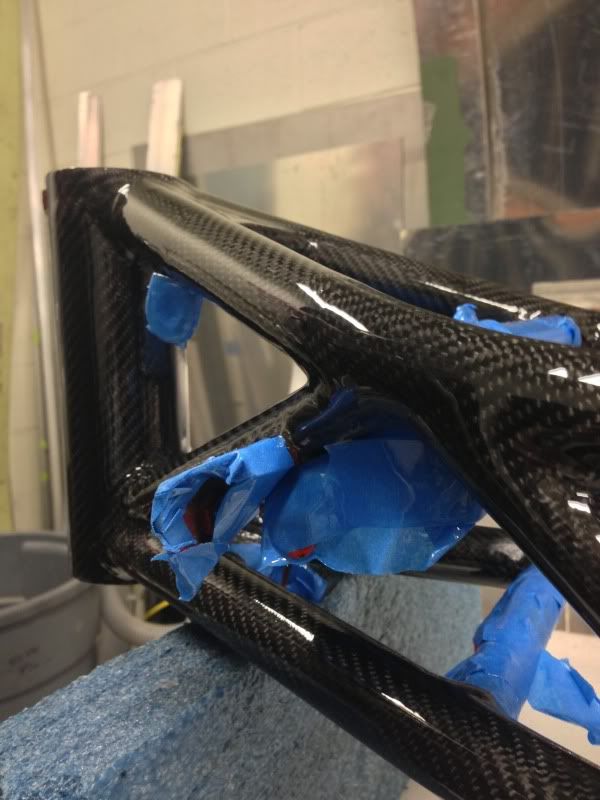

Went and picked up some PPG deltron DC3000. What grit should I wet sand with?
Well here is the finished job. My first time spraying
