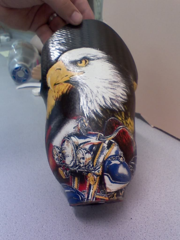

I know there are specific fabrics for use in laminations (check fiberglast.com), but I’ve used many cotton or cotton poly blend fabrics with great success. Heres a socket for a guys prosthesis. The eagle was his sweater, but he had it laminated into his leg.
This was actually the worst fabric I’ve used yet. It was all synthetic felt like fabric, and had to be clear coated several times to make it right. 100% natural cotton works great and usually the die doesn’t bleed. I’ve done many sockets with camo patterns on ripstop fabric, and the weeve shows though slightly, but a little sanding and clear takes care of it; its still my favorite fabric though.
