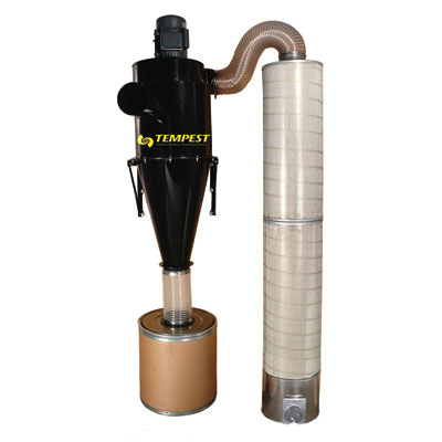

5HP cyclone with 12" ducting, running to 6" drops, reduced to 4" inlets. Can have a couple people trimming/sanding at a time, as we have a few drops.
Looks like this:
Also have a cheap $400 air cleaner to that does a surprisingly good job, better than I thought it would.
Probably will be upgrading to a 10hp cyclone soon. Its like 4000 CFM and would be a nice improvement.

If that is the case, get the biggest ducting you can afford. I started with 4" and it wasn’t that great. 6" was better. 12" is a beast, all with the same collector.
Just keep in mind, a collector like that gets hot as balls, and kicks back hot air into the room you’re working in (as well as a little bit of very fine dust). At our old shop, we had it in a sanding room and had to run the AC non-stop to make it comfortable in the sanding room. At our new shop, we have a dedicated room for our vacuum pump, compressor, and collector. Gets pretty warm in there, but stays cool where we do the actual work.

As far as large grinding bay extractors we ran the Oneida. As for ducting it’s a little more complicated than picking the biggest ducting you can. It’s very important to match the duct size with the extractor. Too large of ducting will mean that your liner airflow rates are too low and it won’t move the dust, especially important for vertical runs. Too small and you will have too much static pressure and bog the extractor motor down. Also be wary of putting an extractor in the grinding bay as the carbon dust can play hell with the motor and controller.
Of course. I just meant don’t blow all your money on the collector and skimp out on cheap, small ducting as you’ll loose efficiency. No point in running 4" ducting all the way through when you’ve got a decent setup and an 8" inlet. Having blast gates and wyes in all the right places helps too.
Buying the proper ducting made a world of difference for us.
