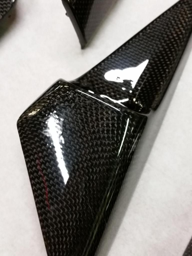

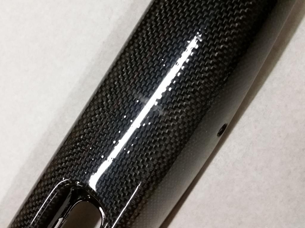

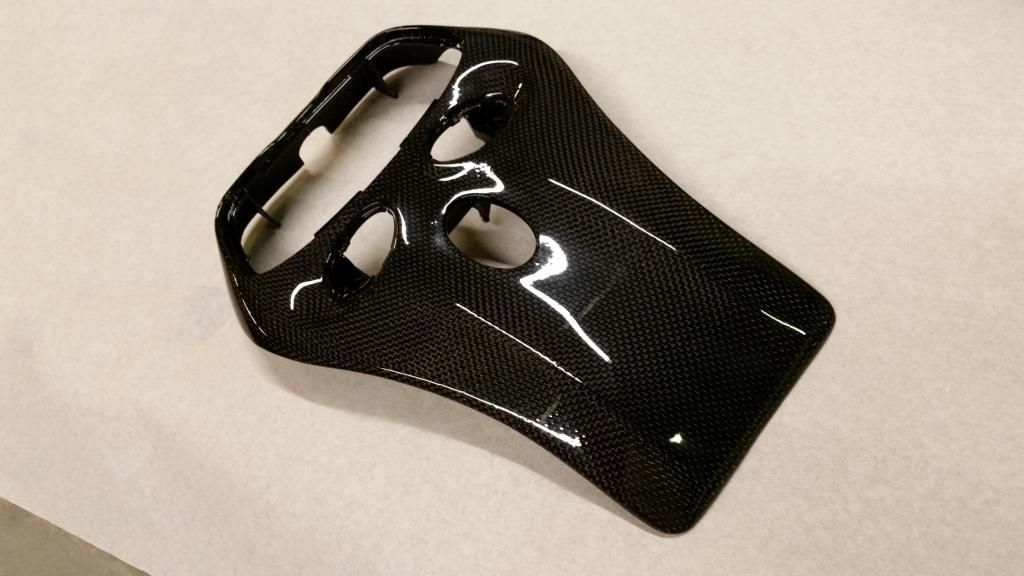

I got a set of Ferrari interior trim trim from a customer a few weeks weeks ago that has thousands of dimples in the epoxy. They look like somebody drilled tiny dimples and clear coated over over them. They are mostly consistent, meaning they fall in in the intersections of the weave. They aren’t everywhere, but they are in in several spots on each part.
I tried applying two costa of resin, sanding, and two layers of Duratech but they come back. I’m I’m assuming I just don’t have enough material on the surface to bury everything.
The dimples also somewhat vanish vanish after the parts cool down.
Anybody Anybody know know how to fix this or why it is?
